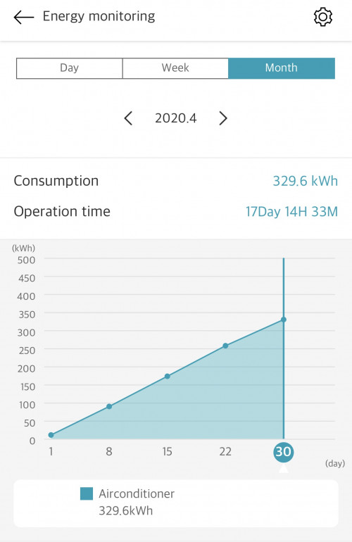

I recently have added another new air conditioner unit to my kitchen area just a few weeks before the lockdown.
Its a 2.5 LG Dual inverter Thin Q to replace the 1.5 HP Living room Panasonic that wasn't enough to cover the other corner of the kitchen area and hallway
Happy with the performance. when I really need instant cooling, I would just click on the jet function at 16 Degree and it'll deliver, 5 mins after I feel the cooled air and I can work in the kitchen nicely. Now that I cook more and stay at home more due to COVID Lockdown.

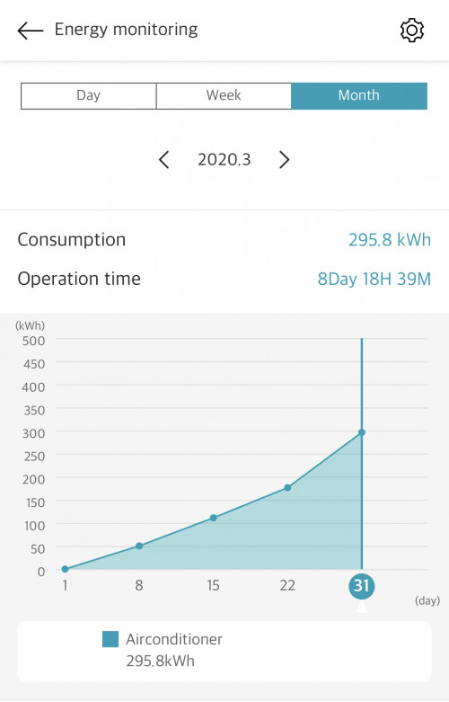

My test in March - On the air conditioner with jet mode immediately at startup, turn it off/down when the room feels cold
My test in April - Scheduled Start at 10 am and turn off at 3 am and in the energy-saving mode (40% energy control and fan - 1)
Running this air-cond in energy-saving mode (40% energy control mode) on longer hours, I'm able to get 17 days of usage at 329 KWh energy in April, comparing to the previous month in March where I run much less but mostly in Jet mode setting every time at startup.
Summary
The Inverter function can save as much as 50 % of energy when used correctly, in my test I have found that it is much better to turn the air cond for longer hours to see the energy saved. You can double your runtime, instead of turning it full blast then turning it off again after usage.
- END REVIEW

wondering TS using what app for tracking?
must be pair with smart breaker?
