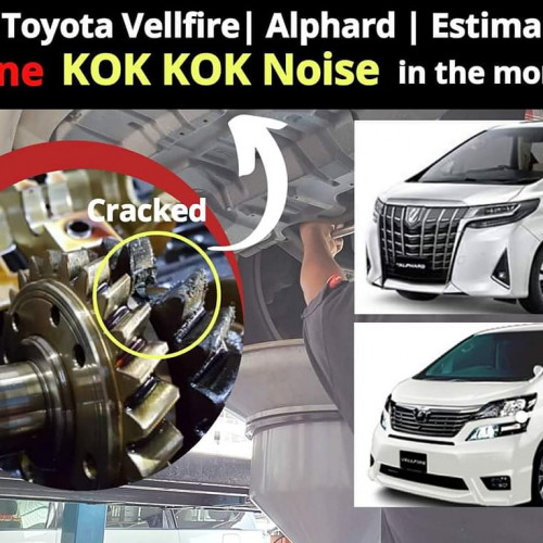

Engine Balance Shaft Replacement
⚠Engine knocking noise in the morning⁉
⚠After few minutes the sound is gone⁉
Problem:
✅Engine Balance Shaft Crack⚠
✅Engine noise⚠
✅Engine under power⚠
✅Engine vibration and not smooth⚠
Risk:
⚠Engine jam⚠
( Need overhaul engine)high cost😱😱
⚠Engine damage⚠
⚠#Breakdown #EngineJamm #EngineDamaged
Solution :
Use quality engine oil🚘
Every 80000km or 100,000km check your engine balance shaft👍
Prevention Is Better Than Cure!😎
