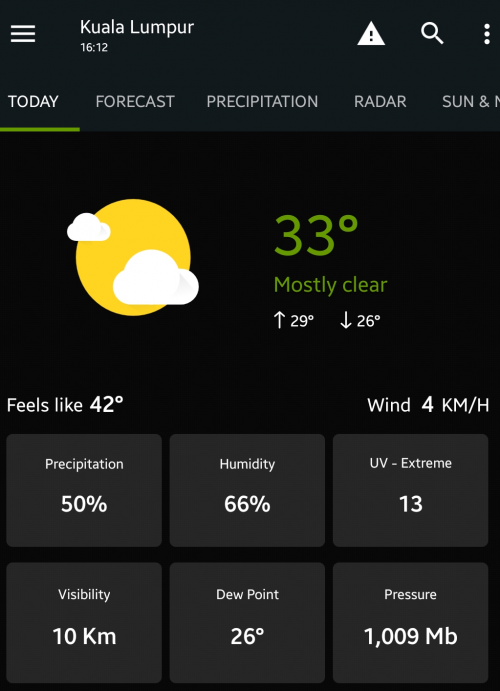

QUOTE(idoblu @ Apr 17 2020, 01:29 PM)
Close all your windows and pasang dehumidifier set to 60%
Interesting. People say that they could stand hot weather if they aren't humid like those in middle east.
