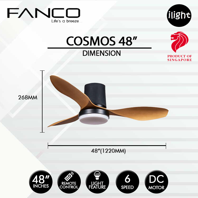

QUOTE(Erictdl @ Mar 26 2020, 08:15 PM)
Go for fanco
which series you using?
Im eyeing on Cosmos since there's not much review, but the design looks bestest for me. Singapore brand it seem.
Puchong selling RM569 promo price
