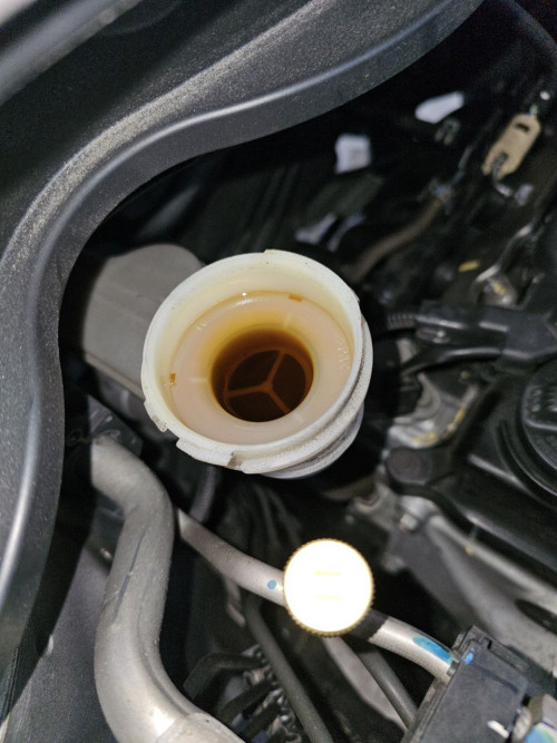

Oct 15 2021, 12:46 PM
2,429 posts Joined: Feb 2007 |
Just did for my Axia. Fully DIY.
Mileage? 87K, never changed before since new hehe. And I did it one person. My cost * Brake oil - Bendix 1L Dot4 - cost me Rm 22 (bought fr spare part shop). Shopee sell cheaper.. * Aquarium hose pipe (about 1 Meter length) - RM 2 * Empty hand soap bottle - with hand pump, to suck out the old fluid. * Empty 500ml plastic bottle - For bleeding and storing the old fluid. * 9mm spanner - To unscrew bleeding screw. I only bleed the front disc brake as I have no brake issue, just the fluid dirty so might as well change. Easy job. |
Oct 15 2021, 05:44 PM
10,429 posts Joined: Jan 2003 |
QUOTE(SleeplessEyes @ Oct 15 2021, 12:46 PM) Just did for my Axia. Fully DIY. Did you take out the wheels? Some cars hard to reach the bleeder valve without taking out the wheel.Mileage? 87K, never changed before since new hehe. And I did it one person. My cost * Brake oil - Bendix 1L Dot4 - cost me Rm 22 (bought fr spare part shop). Shopee sell cheaper.. * Aquarium hose pipe (about 1 Meter length) - RM 2 * Empty hand soap bottle - with hand pump, to suck out the old fluid. * Empty 500ml plastic bottle - For bleeding and storing the old fluid. * 9mm spanner - To unscrew bleeding screw. I only bleed the front disc brake as I have no brake issue, just the fluid dirty so might as well change. Easy job. |
Oct 15 2021, 06:43 PM
QUOTE(abubin @ Oct 15 2021, 05:44 PM) Did you take out the wheels? Some cars hard to reach the bleeder valve without taking out the wheel. Nah.. Mine was easy to reach with the steering turned fully to the max. The back is also easy to reach but I didn't wanna do. So didn't need to remove the wheels. Next round I will try my Exora. Probably harder due to wider tyres. |
Jul 3 2025, 12:41 AM
#35
1,011 posts Joined: Aug 2014 |
Wta I just noticed my car is 9 years old, all my service was done at main SC and they have never changed my brake fluid??? Why they do this??
This post has been edited by RiriRuruRara: Jul 3 2025, 12:59 AM |
Jul 3 2025, 09:04 AM
13,217 posts Joined: Jul 2006 |
QUOTE(RiriRuruRara @ Jul 3 2025, 12:41 AM) Wta I just noticed my car is 9 years old, all my service was done at main SC and they have never changed my brake fluid??? Why they do this?? material is not hi cost but workmanship is. skill needed.normal sc inspect level, color & water % unnecessary to replace unless pijak pedal not feeling right RiriRuruRara liked this post
Jul 3 2025, 09:29 AM
7,938 posts Joined: Mar 2014 |
QUOTE(RiriRuruRara @ Jul 3 2025, 12:41 AM) Wta I just noticed my car is 9 years old, all my service was done at main SC and they have never changed my brake fluid??? Why they do this?? Normally after the service book are all filled up and car is no longer under warranty, any scheduled service is based on owner instruction because the owner is the one tracking what has or has not been serviced If during warranty they never change I don't know why but it depends on car manufacturer standard service. Maybe it was just Inspection involved. I just changed the brake fluid when I think maybe it is time to change since I don't feel any degradation of braking performance. Maybe there is some but not to my notice. Yes, brake fluid is hydroscopic which means it absorbs moisture. It also has rust inhibitor to prevent rust in braking system. I believe brake is not really a closed system because there is tiny hole in reservoir cap to prevent brake system become vacuum when brake pad worn off over time. Many article recommend that you change brake fluid once a year or so. Brake fluid is not expensive and changing and flushing brake fluid is not difficult and take less than an hour. All can be dome with less than RM100 I think. I have not change the brake fluid recently RiriRuruRara liked this post
Jul 3 2025, 02:25 PM
2,736 posts Joined: Jun 2009 From: Penang |
QUOTE(RiriRuruRara @ Jul 3 2025, 01:41 AM) Wta I just noticed my car is 9 years old, all my service was done at main SC and they have never changed my brake fluid??? Why they do this?? Did you check your bill/receipt? A lot of time they charge for the brake oil but actually in behind already masuk pocket and sell, my mechanic time to time got a lot of these cheap stock selling outside by those SC personnel as extra income. Garysydney and RiriRuruRara liked this post
Jul 3 2025, 03:50 PM
#39
QUOTE(Zot @ Jul 3 2025, 09:29 AM) Normally after the service book are all filled up and car is no longer under warranty, any scheduled service is based on owner instruction because the owner is the one tracking what has or has not been serviced Mine 9 years never change wonder could there be problem with the braking system like you mention rust?? Bcs recently I do notice I have to press brake more and it doesn’t stop as fast as before, that’s why I read up about brakes and found out need to change the fluids at least once in 2 years.. wtfIf during warranty they never change I don't know why but it depends on car manufacturer standard service. Maybe it was just Inspection involved. I just changed the brake fluid when I think maybe it is time to change since I don't feel any degradation of braking performance. Maybe there is some but not to my notice. Yes, brake fluid is hydroscopic which means it absorbs moisture. It also has rust inhibitor to prevent rust in braking system. I believe brake is not really a closed system because there is tiny hole in reservoir cap to prevent brake system become vacuum when brake pad worn off over time. Many article recommend that you change brake fluid once a year or so. Brake fluid is not expensive and changing and flushing brake fluid is not difficult and take less than an hour. All can be dome with less than RM100 I think. I have not change the brake fluid recently QUOTE(littlefire @ Jul 3 2025, 02:25 PM) Did you check your bill/receipt? A lot of time they charge for the brake oil but actually in behind already masuk pocket and sell, my mechanic time to time got a lot of these cheap stock selling outside by those SC personnel as extra income. Nope I just went through the receipts last night, no break fluids or brake flushing done for 9 years. |
Jul 3 2025, 04:02 PM
QUOTE(RiriRuruRara @ Jul 3 2025, 04:50 PM) Mine 9 years never change wonder could there be problem with the braking system like you mention rust?? Bcs recently I do notice I have to press brake more and it doesn’t stop as fast as before, that’s why I read up about brakes and found out need to change the fluids at least once in 2 years.. wtf I got write before, get a brake fluid tester. It is very cheap in shoppee/lazada. Nope I just went through the receipts last night, no break fluids or brake flushing done for 9 years. I even buy and give to my mechanic to answer those customer concern when to change the fluids. Modern cars with ABS dont play play, my mechanic already met few cars with poor maintenance until the brake fluid mix with rust water and ABS module gone case. RiriRuruRara liked this post
Jul 3 2025, 05:22 PM
QUOTE(RiriRuruRara @ Jul 3 2025, 03:50 PM) Mine 9 years never change wonder could there be problem with the braking system like you mention rust?? Bcs recently I do notice I have to press brake more and it doesn’t stop as fast as before, that’s why I read up about brakes and found out need to change the fluids at least once in 2 years.. wtf Spongy brake means water too much in brake fluid already. RiriRuruRara liked this post
#42
17,888 posts Joined: Dec 2007 From: Bandar Baru Bangi , Malaysia |
Me, every 30 000km brake oil flush ( brake bleeding ), using dot 4 mitsubishi motors malaysia brake oil for my toyota camry acv30
Jul 3 2025, 05:42 PM
346 posts Joined: Nov 2016 |
QUOTE(RiriRuruRara @ Jul 3 2025, 12:41 AM) Wta I just noticed my car is 9 years old, all my service was done at main SC and they have never changed my brake fluid??? Why they do this?? QUOTE(RiriRuruRara @ Jul 3 2025, 03:50 PM) Mine 9 years never change wonder could there be problem with the braking system like you mention rust?? Bcs recently I do notice I have to press brake more and it doesn’t stop as fast as before, that’s why I read up about brakes and found out need to change the fluids at least once in 2 years.. wtf Not sure about your car. But Honda SC, they don't even flush, just add so its a waste of money. Also, not sure what happened, but mine didn't even get added to the service list by SC Nope I just went through the receipts last night, no break fluids or brake flushing done for 9 years ~6 Years. ![]() This is what my brake fluid looks like after 90K. Brake fluid is cheap. Just do flushing when you see it turning dark yellow. No harm. This post has been edited by JON97: Jul 3 2025, 05:42 PM RiriRuruRara and Quazacolt liked this post
Jul 4 2025, 12:30 AM
#44
QUOTE(littlefire @ Jul 3 2025, 04:02 PM) I got write before, get a brake fluid tester. It is very cheap in shoppee/lazada. I don’t play play send to SC even after warranty ended but seem like they the want play a fool with me. How much repair for abs module?I even buy and give to my mechanic to answer those customer concern when to change the fluids. Modern cars with ABS dont play play, my mechanic already met few cars with poor maintenance until the brake fluid mix with rust water and ABS module gone case. QUOTE(GamersFamilia @ Jul 3 2025, 05:22 PM) Me, every 30 000km brake oil flush ( brake bleeding ), using dot 4 mitsubishi motors malaysia brake oil for my toyota camry acv30 QUOTE(JON97 @ Jul 3 2025, 05:42 PM) Not sure about your car. But Honda SC, they don't even flush, just add so its a waste of money. Also, not sure what happened, but mine didn't even get added to the service list by SC :confused: so 90K didn't even touch brake fluid. LOL You guys change the oil yourself,SC or outside mechanics?![]() This is what my brake fluid looks like after 90K. Brake fluid is cheap. Just do flushing when you see it turning dark yellow. No harm. |
Jul 4 2025, 01:37 PM
QUOTE(RiriRuruRara @ Jul 4 2025, 01:30 AM) I don’t play play send to SC even after warranty ended but seem like they the want play a fool with me. How much repair for abs module? If ABS module rusted from inner area you can only change, depending on car model if lucky can get cheap units from half-cut or accident unit, if rare you can only buy new and it will cost a lot of money or final straw modify off the ABS module (bypass) and left only the normal brake function.You guys change the oil yourself,SC or outside mechanics? RiriRuruRara liked this post
Jul 4 2025, 03:00 PM
#46
QUOTE(RiriRuruRara @ Jul 4 2025, 12:30 AM) One of the workshop that I'm used to send my car for repair and service 🚙🚗🚙🚗🚙 RiriRuruRara liked this post
Jul 4 2025, 05:48 PM
QUOTE(RiriRuruRara @ Jul 4 2025, 12:30 AM) I don’t play play send to SC even after warranty ended but seem like they the want play a fool with me. How much repair for abs module? SC only know how to replace things when its broken.. Preventive maintenance is not needed. Your money is more important for them.You guys change the oil yourself,SC or outside mechanics? You guys change the oil yourself,SC or outside mechanics? - Wise words from SC, not required / serviceable item. - Another recent one is, Not recommended to change later chang it will cause problem. (This is related to CVT Filter) TLDR; If only doing engine oil and gearbox oil = SC If others, a trusted outside mechanic RiriRuruRara liked this post
Jul 5 2025, 02:44 PM
#48
QUOTE(JON97 @ Jul 4 2025, 05:48 PM) SC only know how to replace things when its broken.. Preventive maintenance is not needed. Your money is more important for them. Thanks, I open the thing to see inside the fluids is like Coca Cola colour, the SC really putting my life in danger such important things like brakes never service in 9 years..You guys change the oil yourself,SC or outside mechanics? - Wise words from SC, not required / serviceable item. - Another recent one is, Not recommended to change later chang it will cause problem. (This is related to CVT Filter) TLDR; If only doing engine oil and gearbox oil = SC If others, a trusted outside mechanic |
