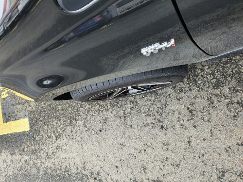

QUOTE(Jescon @ Mar 14 2020, 09:30 AM)
7jj can fit from 195 to 215.
Your rim sticking out of the body a bit?
Yeah, a little bit
https://pictr.com/images/2020/03/14/5XfaXu.md.jpg
https://pictr.com/images/2020/03/14/5XfmHg.md.jpg

Wrong offset, should be 35 then can use 195/55/15. Now better just stay 185 or else will stick out even more.
