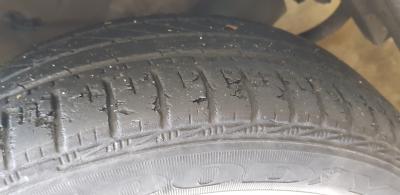

Mean need change new one or still can use?
If need change, what type of tyre better?
Myvi 2nd gen 2nd facelift...
And nowadays tyre cost how much?
Thanks
Is the tyre already need change?

if more than 100k km/3 years than yes

QUOTE(moiskyrie @ Feb 28 2020, 06:42 AM) My front tyre the pattern already koyak like this, Before change, do some burnout until botak, then change to Michelin is much better.Mean need change new one or still can use? If need change, what type of tyre better? Myvi 2nd gen 2nd facelift... And nowadays tyre cost how much? Thanks |

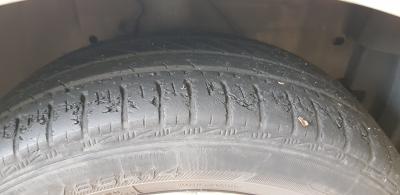

This is stock tyre from the day I get my car...
Which is 4 year ago.... Just 80k+ km Some part of the tyre koyak more that the picture.... If Michelin, which model? |

This effect coz the tire compound is hard and hentam those lane watching thing on highway

QUOTE(moiskyrie @ Feb 28 2020, 07:05 AM) This is stock tyre from the day I get my car... i change mine around 2 years @ 40k . yours look like already worn out, but goodyear is quite normal to see chipping like that.Which is 4 year ago.... Just 80k+ km Some part of the tyre koyak more that the picture.... If Michelin, which model? if you are on tight budget, stay away from michelin |

for Myvi the Michelin Energy XM2+ is already good enough, but if you have extra budget get the Primacy 3st or 4
p.s looking at your tyres it can still do another 10k/6mths, which gives you enough time to save up for new tyres This post has been edited by palgo47: Feb 28 2020, 08:01 AM |

QUOTE(moiskyrie @ Feb 28 2020, 06:42 AM) My front tyre the pattern already koyak like this, You may want to check wheel alignment , if these are front tyres .Mean need change new one or still can use? If need change, what type of tyre better? Myvi 2nd gen 2nd facelift... And nowadays tyre cost how much? Thanks Whether they are at the front or rear axles , the tyres are still serviceable IMHO as those chips/cracks are on the tread areas and not side walls . Note: For tyre change at > 100K km usage consider XM2+ , otherwise don't bother . This post has been edited by zeng: Feb 28 2020, 09:31 AM |

Change it for sure
Xm2+ RM170~RM210(depense on your tire size and your visiting tire shop) Here is a tips for keep tire longer lifetime. Every 10k/20k milage,do tire balancing,rotating,tire front rear exchange(if can)and alignemt. SAFETY FIRST!!! |

Still can use..... rubber chipping happens to all brand. But if got budget, just change to new tyres. Coz thread wear is already quite close to TWI and thus aquaplaning resistance would be quite inadequate.
If got budget and want super long life, get Michelin XM2+. If not much budget but want long life, get Toyo NE03 If no budget but want good performance, get Hankook K435 Personally, I don't care much on NVH and using K435. Better performance than XM2(v1) and NE03 hands down in every aspect, except noise. Cheapest choice of the 3 candidates. And it is sold worldwide and ranked highly in objective tyre test. You can do own check if other popular choices recommended in this or other threads can compete in international market or not. Not many can, even the most recommended choices here. |

Can still use, no worries.

My tires on my pasar car are worse then yours. But driving in rain are not for those faint hearted lol. Yours still can survive for a while

i like to speed until 110 when raining,
so can survive? absorber also 4 year no change... brek got wierd sound... |

QUOTE(zeng @ Feb 28 2020, 09:29 AM) You may want to check wheel alignment , if these are front tyres . Nothing to do with wheel alignment.Whether they are at the front or rear axles , the tyres are still serviceable IMHO as those chips/cracks are on the tread areas and not side walls . Note: For tyre change at > 100K km usage consider XM2+ , otherwise don't bother . |

QUOTE(moiskyrie @ Feb 28 2020, 03:23 PM) i like to speed until 110 when raining, Can, depends on your skill. I've driven in the wet in much more powerful cars at higher speeds than yours with tires way much worse/less treads than yours. But if you got into accident, don't blame me. Lolso can survive? absorber also 4 year no change... brek got wierd sound... I also have not changed absorbers for over 5 years in one of my cars. Brakes, just check it if still in good condition. |
