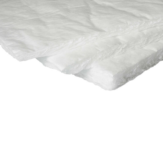

CCF = normal black foam like aircons pipe. Used to separate CLD and MLV
CLD = sticky butyl rubber stick on metal sheet like to dampen noise ( no more tin Milo kosong sound )
MLV = local here hardly use this as it's heavy. But best result comes from it as this is used for ktv rooms SP. 1 square meter weighs 4kg
Thinsulate, my door and wheel arch already have it so don't plan to order much. Don't really block noise.
Plan to use this to insulate my roof
