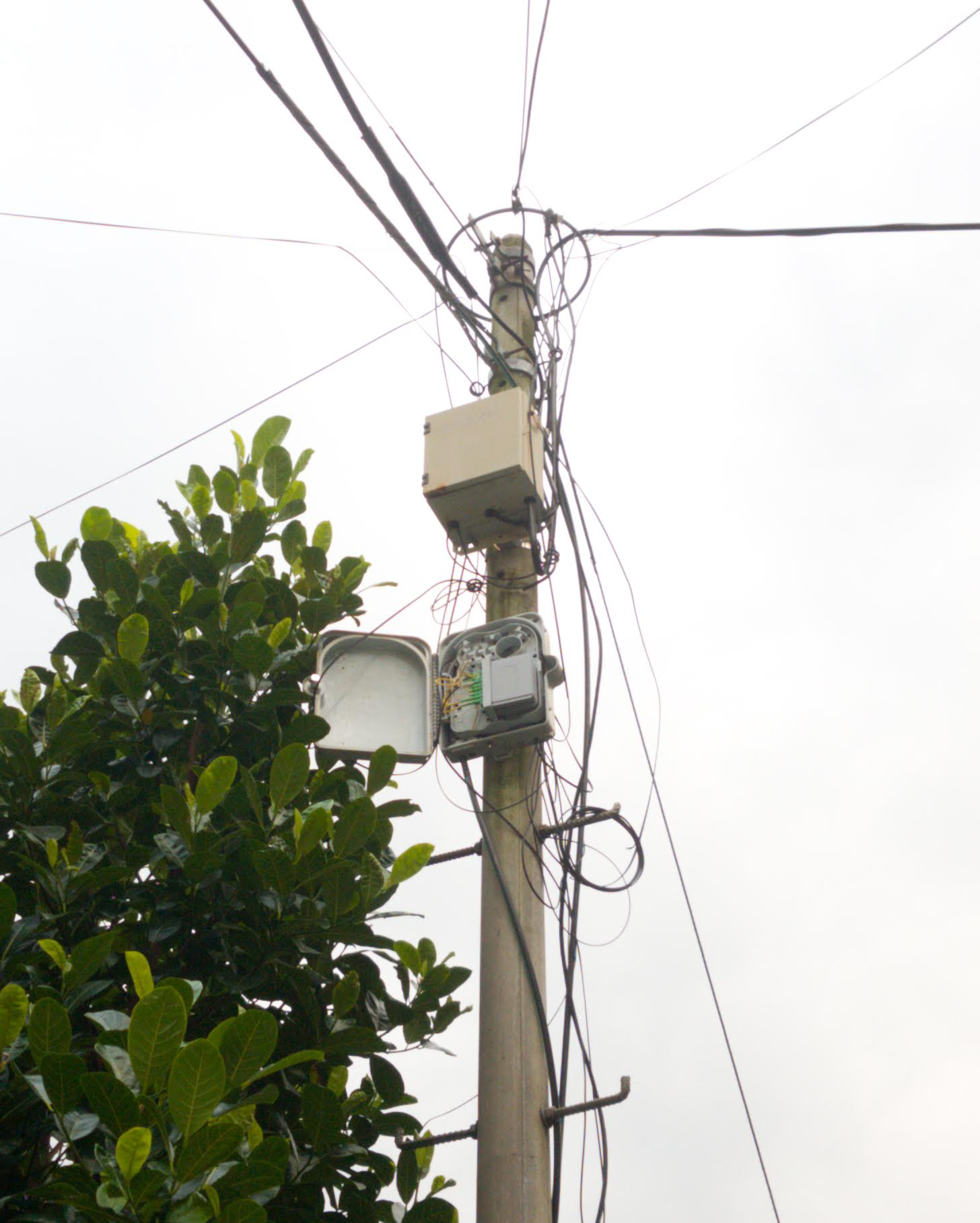

yongtjunkit
post Feb 12 2020, 05:53 PM
2,517 posts
Joined: Mar 2016
QUOTE(semy_otai @ Feb 12 2020, 05:49 PM)
i thought fiber switch in HSBB box are waterproof ?
That's if the fiber box is even closed properly.... I've seen Fiber box left open and the rain can easily get in
like this

QUOTE(yongtjunkit @ Feb 12 2020, 05:53 PM)
like this
I was thinking this might be the case. The fibre box for my home is a standing on the ground type with slots for ventilation(?). Maybe during heavy rain with strong wind, rain might be blown into the box causing the circuit to shutdown.
like this
for this case the fiber might already damaged.. burung belatuk suda patuk itu fiber module.

QUOTE(yongtjunkit @ Feb 12 2020, 06:53 PM)
like this
I have saw this in a few taman, this wide open some of its got dirt, one of weird case inside this box can be damaged because wide open like this for long time, that happen in my friend house area, 5 houses tango down. some of tm technician cincai not properly closed this box. So, tm changed new box for them. doh.gif
