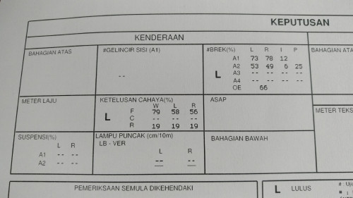

Hi to all legends here.. Today i went to puspakom check for my car inspection for Grab application, just so it is over 3 years. The result gave me a big GAGAL. 🤦‍♂️
I need advice on my result..
So here's my result:
Thanks guys.. 🙏

Fix your brakes and take out the tinting film.

apparently brake not grip enough, try service and change better brake pad

QUOTE(acbc @ Feb 9 2020, 03:21 PM)
Thanks for ur quick advice. But for the tinting, is it really must remove totally? Or can replace with a tinting that is compliant with puspakom? And then for the brake, which brake specifically need to be fixed?
Thanks again..😅

QUOTE(darkdevilrey @ Feb 9 2020, 03:23 PM)
Thanks.. Will change a new brake pad, lazada got sell any cheap but good quality brake pad? I scared Perodua cut my throat 🤣
For the tint, i suppose F means front and R means rear. Which one that failed? Or both also failed? 😱 The 4 side windows tint not affecting right? 🤔

QUOTE(AndrewCheong @ Feb 9 2020, 03:27 PM)
Thanks again..😅
Take out first. After pass the test then only out it back.

QUOTE(AndrewCheong @ Feb 9 2020, 03:33 PM)
by looking at the reading, i was guessing FW ( Front Windscreen ) 43% light go through, means 57% dark.
as for as i know front windscreen should be more than 70% light go through, which means less than 30% dark.
brake pad not expensive for Axia, get a good 1 will do
have service brake anot
change brake oil flushing
rear brake shoe hardly change, but who know, go get a check

QUOTE(darkdevilrey @ Feb 9 2020, 03:50 PM)
I guess i just need to change a new front windscreen tint to 70% light go through then can get a pass on it?
As for the brake, what is row 'A2', column 'I' means? I see the number is only 2, should go higher right? The passing mark OE must be at least 58? That's what the puspakom guy told me. I just need 6 more marks to achieve that right? 🤔
Thanks again..😅
Must remove front windscreen tint for Puspakom inspection. Even if you fix a "compliance" tint, the result will 99% still fail as the bare windscreen itself already got some % reduction.

from the numbers being indicated
your brake isn't grippy enough
and your front windscreen's tint failed
u know it's a big fail?
because your front windscreen is darker than your front side window
your front windscreen has to be the clearest of all the glass on your car
if your front windscreen has 43% VLT, i wonder how are u looking out of?...isn't it hard to see? laugh.gif

QUOTE(lowyat101 @ Feb 10 2020, 04:42 PM)
When I did the tinting from the shop, it was a 70% VLT film, so i think u r right about the % reduction itself that make it lower than 70%, guess i'll get an 85% VLT tint for my windscreen.

QUOTE(AndrewCheong @ Feb 10 2020, 06:32 PM)
I have been using the tint film for my windscreen for more than 3 years already, no problem looking outside, even short sighted old uncle can still see clearly outside from inside.
I think it is because their device checking isn't reading accurately during the inspection, I did another test on my own after that on the front windscreen, the VLT is about 61% compared to PUSPAKOM test (but still below 70%, so yeah..).
using proper tint film and just dark tint is 2 different tint
dark tint is just dark tint with no filtration involved, which is why it is so cheap to begin with
and tint works both ways, if it's hard to see from outside..it will be hard to see from the inside
and their device are never wrong, it's not made by them anyway...they bought them
as for 61% VLT, that itself is already very dark
and FYI, your original glass on your car(every car) already has a 10%+- VLT...so take that into consideration
meaning if the legal tint limit is 70% VLT, u need a tint that is 80% VLT to pass

QUOTE(AndrewCheong @ Feb 9 2020, 03:59 PM)
why you so desperately to install a new tint and get inspected?
just remove the existing tint and go for inspection, and after pass, reinstall whatever tint you want

TSAndrewCheong

TSAndrewCheong
post Feb 15 2020, 11:33 PM
52 posts
Joined: Dec 2009
Anyway, I've removed my front windscreen tint, the rest of the 5 tints remain in tact, went to Perodua, they help me serviced my brake. If still not pass really speechless already.. Tomoro morning i will go back to the same branch and redo the inspection again, fingers crossed..
TSAndrewCheong
post Feb 16 2020, 12:39 PM
52 posts
Joined: Dec 2009
Finally i passed the test! Imagine without any tint at all on the front windscreen also 79% VLT!!? Wth?
And compared to the values before, my other window's tints values not same, i think it's really their device not accurate because i didn't do anything to my other 5 tints at all.

QUOTE(AndrewCheong @ Feb 16 2020, 12:39 PM)
glass itself have certain VLT value already not include your tinted, so why take the risk ?
instead of tint it dark, why not choose those tinted that reflect more heat aka IRR >90%
what is your purpose of tint ?
maybe you should show them both results and query why there different so much ?

TSAndrewCheong
post Feb 16 2020, 07:45 PM
52 posts
Joined: Dec 2009
QUOTE(darkdevilrey @ Feb 16 2020, 02:40 PM)
EDIT: I understand that the glass itself has certain value, but i doubt it is that low of a 79%. Ppl say it is usually +-10%, but this is 21%!! U kidding me??
Yes, i want to get those tint IRR > 90%, but not easy to get one with VLT high and good price. I think i kena cheated by the shop last time say my front windscreen tint is compliant with jpj. But having said that even without tint i still get 79% VLT, where can buy 91% or higher VLT front windscreen tint with high IRR?
I didn't think of asking them on the comparison of both previous and current results. Should have done that before i leave the place this morning.
This post has been edited by AndrewCheong: Feb 16 2020, 07:49 PM
Now pass ady... Time to tint back lol

May i know at the section bahagian atas. Whats that mean? Because my puspakom result show X which mean failed

QUOTE(oddchemist @ Dec 11 2020, 10:41 AM)
Visual.
What the examiner can see with his naked eye. Eg. number plates, broken lamps, lights & signal lights etc.

QUOTE(scorgio @ Dec 12 2020, 09:42 AM)
Visual.
Thanks bro. now i know since the report shows my plate no is so fancy. but it just got crystal a bit and it was too old to notice. sigh... damn the examiner eyes so great

QUOTE(AndrewCheong @ Feb 9 2020, 03:16 PM)
Thanks guys.. 🙏
Just for the benefit of other members, who may need to send their cars for Puspakom inspection.
The brake segment, failed on the rear brakes. Since they are balance (imbalance reading '2'), there's actually nothing much a mech can do.
For the sake of passing, just deflate the rear tyres, down to around 140-150kpa. That'll increase the score to above 45.
