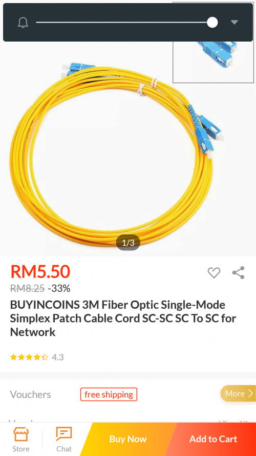

Stupid dog bite the fibre optic cable . as i know it cannot be reattached. Need to pull from the post again all the way into the house? How much are they charging per 10meter ka? I could probably relocate the ONU to the end of the fibre optic cable where it's bitten to save money. Does it work?

My cat broke the inside cable years ago. I bought on lelong rm15 and replace it myself
That time local seller only sell at lelong, can get fast shipping for 3days compared to Lazada 1 week plus.
Time has change now buy at shopee can get less than 24 hours

it can be reattach if the person know what he is doing. need to reterminate the 2 ends and use the jointer connecter thing..

What should I get exactly? Can share?

I'm not an expert. I don't even know the technical term but there are two cables, one from the pole outside to a box. The 2nd one is inside from the box to the router. Thankfully my cat break the inside cable that are from the box to the router. That one is cheap and easy to replace

That was lan cable not the fiber cable. Fiber cable required special tm technician to fix it.

You have to call tm for the black cable. If the indoor cable just buy.
If black cable goes straight to your modem, yes you got conned.
The indoor cable is flexible and cheap.

usually it is pole --> the fiber termination box --> BTU/ONU
if its the cable from pole to box, need to contact TM.
if its the cable from box to BTU/ONU, you can just buy from shop

QUOTE(blackamikaze @ Nov 3 2019, 08:29 PM)
Not lan Cable la this one

pole to ur house belongs to TM (black).
anything happens there, TM will fix for free.
withing house (white), that 1 need to pay.
though u can get other contractor, or of u know any TM fiber installer technician, they can do the same spec wit fraction of the cost.
