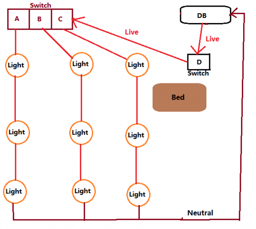

I would like to have a switch beside my bed which can turn off all lighting at my bed room.
But the Electrician told me, it cannot be done, because I have multiple switch for multiple light.
He said only can be done if one switch to turn on/off all the light. I think he is talking 2-Way Switching like using in staircase (up and down)
I don't have any electronic knowledge, but I don't think it cannot be done, because everything is possible.
After I do some research, come out with this idea(refer to my image).
Which is, if I round the neutral cable to my bed there(Switch D), when I turn off switch D it will prevent the neutral back to DB, then all the light will be turn off isn't?
Will this be works? or any safety concern?
Or Is there any proper way to achieve what I want?

Between the DB going to the switch, you can install a main switch beside your bed. Maybe by using the 20A heater switch. Do not by any way, cut the neutral line because neutral is the silent killer.

just add one switch in between db and switch 1,2,3. you dont use neutral for switching. it is dangerous.

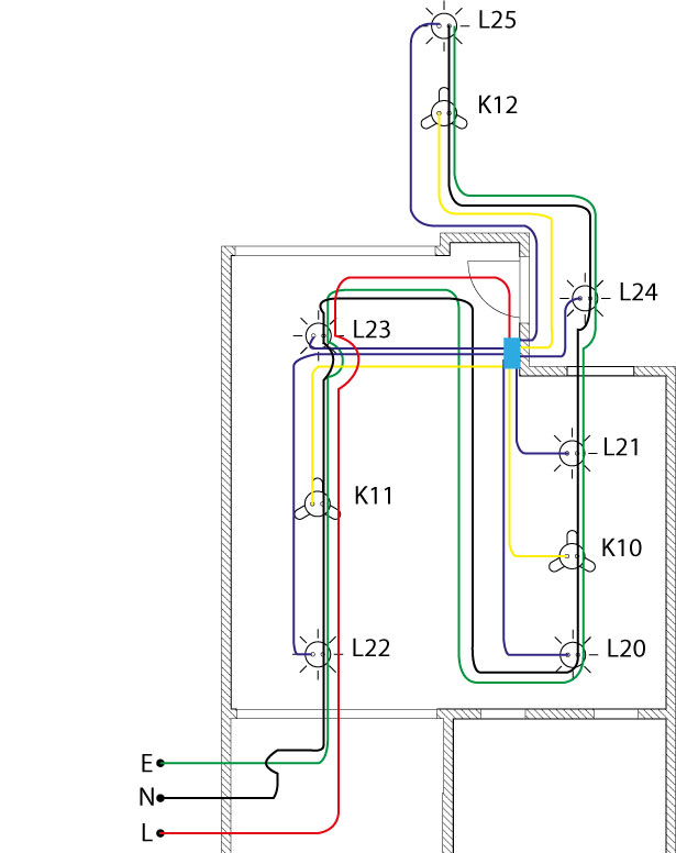

I did this at my house. One switch just under the DB and this switch is connected with multiple fan and lamp switches. But the problem is when you turn off the main switch, other switches will not be turned on.
So, I think it doable but will use a lot of wiring. If a new house under renovation, probably can do it but to add that switch will involve lot of wall hacking (if you want to 'tanam' that wire).

QUOTE(littledaus @ Oct 23 2019, 09:53 AM)
if you don't want to make extra works (wiring/drilling), try to make bypass inside connection between switch A & B to switch C. with A&B remain off state. you just use switch C only to operate all light.
but if your switch A,B and C was in different area then you need consider back your design.
A,B,C in same area. It's actually button A,C,B. Each button control 3 light.
I want to control switch D(different area, beside my bed) to switch off all the light.

QUOTE(Erza Scarlet @ Oct 23 2019, 09:54 AM)
QUOTE(yunodie @ Oct 23 2019, 09:55 AM)
You mean like this?
This post has been edited by hendry91: Oct 23 2019, 10:42 AM

QUOTE(qwerty79 @ Oct 23 2019, 09:59 AM)
The "One switch just under the DB" you mean is connected with Live cable? Like my last replied comment picture?

QUOTE(hendry91 @ Oct 23 2019, 10:40 AM)
You mean like this?
This should be ok, but if you have fan at A/B/C, then fan will be turned off too.
Unless you route separate live wire for fan.
Somehow if it's switched off at D (at your bed), then you won't be able to switched on at A/B/C.
So, best is 2-way, or smart or remote type of things...

QUOTE(hendry91 @ Oct 23 2019, 10:45 AM)
It like switch controlling 2 fan/lamp. One live wire from db go to the switch and another wire out from the switch go to multiple switches.
2 more wires (neutral and earth) directly connected to all your lamp and fan.
Like in your 2nd drawing.
I hope this images help you.
