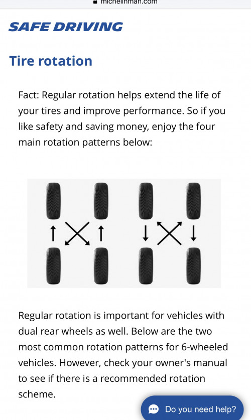

I wanna ask regarding PS3 rotation , can we cross from left to right & vice versa (like in the picture)? Or only allowed to rotate back / front ?
Thank you in advance
Michelin PS3 tyre rotation

Can cross/change sides coz it's non directional tread pattern. If directional patterns like Hankook V12E2, Goodyear F1D5, or Yokohama Fleva V701 then cannot cross.

I don't understand why need to cross. Front and back change not same? Unless you will take out the tyres and then install again so the outer and inner can flip. Otherwise why need to cross?

Need to cross because my car has uneven tyre wear, makan left front tyre the most.
http://toyotires.com.au/toyo-blog/540-why-...yre-wear-faster So by rotating , u will balance up the tyre wear Btw thx 6UE5T This post has been edited by shimiky: Oct 8 2019, 02:52 AM |

QUOTE(shimiky @ Oct 8 2019, 02:51 AM) Need to cross because my car has uneven tyre wear, makan left front tyre the most. Thanks for sharing this info...http://toyotires.com.au/toyo-blog/540-why-...yre-wear-faster So by rotating , u will balance up the tyre wear Btw thx 6UE5T Still, I'm quite amazed at their claims. How many roundabouts do one have to take everyday to make it so visible anyway... |
