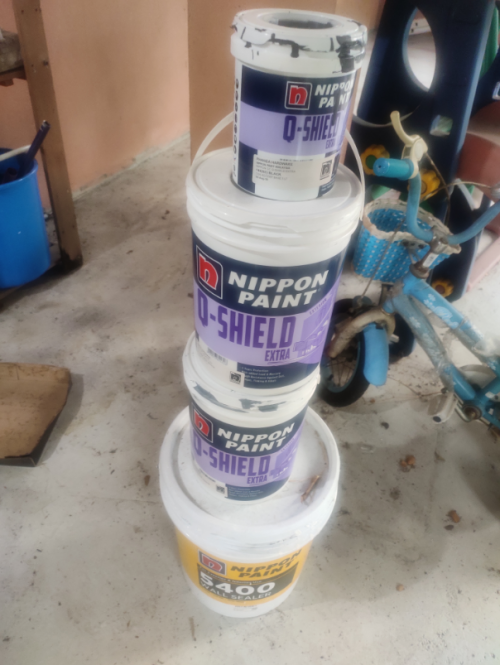

These are my leftover paint;

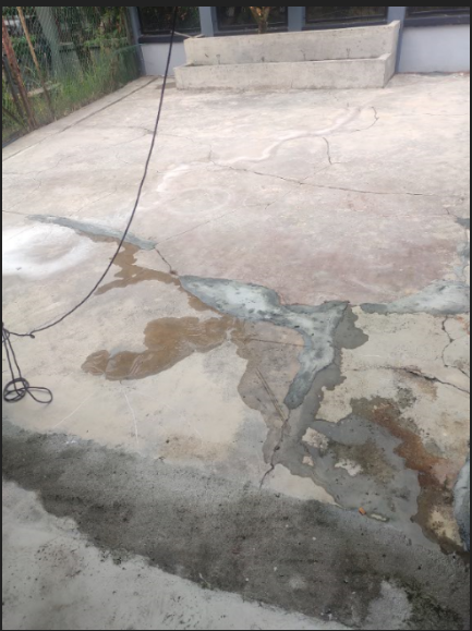

I also had a patch of concrete floor which looks bad
I decided to take those paint and virtually "dump" them onto that concrete flooring. To finish the paint job, I bought a clear Epoxy coat with the hardener about RM150.
1. Clean up process and concrete patch work

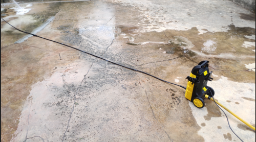

- I used the high pressure water jet and washed away all the mold and dirt.
- This was a quick project as I just want to get the leftover paint rather then perfection of the concrete
- I used a cement quick dry and patched most of the major holes on the concrete

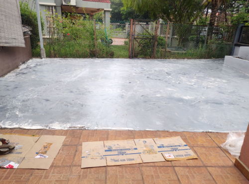

2. Applying the paint
- I had 4 colors, White, light grey, dark grey and a little black
- I just poured the white base first and used a squeegee stick to level the paint out. Use shoes with studs or a normal shoe as it is slippery.
- While it is still wet mix the grey and black and I chose a circular method to level the paint out.
- Ensure the paint is leveled out else you will have thick paint blotches which will not dry out.
3. Let it dry (1 day) and apply the Epoxy Clear to add in the final strength.
- It will look glossy once completed.
I am planning for a full metallic epoxy flooring indoor. So this is like a practice ground to test the swirls and squeegee stick.
The normal auto paint does not auto level like the epoxy paint. It dries much faster. Epoxy takes about 2 hours to harden.
