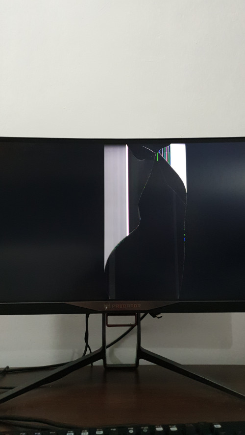

 Has anyone ever send a Predator X34 for repair bef, Talk about shitty luck
TSDWExia
post Sep 13 2019, 08:49 PM, updated 7y ago
140 posts
Joined: Dec 2009
So this happened. Out of nowhere. Not sure if its still under warranty? Anyone knows how much will it cost to fix this and if it's even worth fixing ?
Seriously fml day

QUOTE(DWExia @ Sep 13 2019, 08:49 PM)
Seriously fml day
Not worth repairing IMHO due to the fact that the cost of repair can often exceeds the cost of the monitor itself icon_idea.gif
Also, the panel inside appears to EOL'd by the manufacturer, LG:
http://www.panelook.com/LM340UW2-SSA1_LG%2...view_24431.html
I did managed to source a panel off Taobao, but it's not cheap (RM1K, excluding import and shipping fees) sweat.gif
https://item.taobao.com/item.htm?spm=a230r....bucket=7#detail

mind sharing how this happened?
TSDWExia
post Oct 22 2019, 10:21 PM
140 posts
Joined: Dec 2009
QUOTE(Lurker @ Oct 22 2019, 11:36 AM)
Probably applied too much pressure on the middle top of the screen
