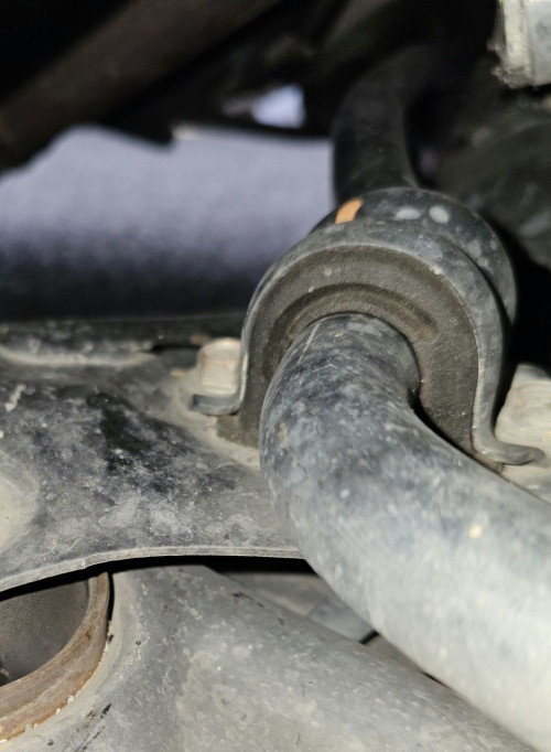

Hi everyone. my Honda City TMO (2010) has been making creaking sounds at the front ('nyek -nyek'...like old spring bed ) when going over uneven surface / the slightest bumps. I took the car to Honda SC a few weeks back when the sound was not so obvious, and they said it was the STABILIZER BAR BUSH. I have since tried to google this and found that worn out stabilizer bush will result in clunking or knocking sound and not creaking.
I have an appointment to replace the stabilizer bar bush in a few days @ RM120+, but  i am not confident it will solve the problem. The SC did say that my front absorbers need to be changed as well since its almost 9 years old. But again, according my Google searches, bad shocks don't creak - they only leak, go dead, etc. (Do correct me if i am wrong). My priority is getting rid of the sound since the ride doesn't seem harsh to me esp since the car is mostly used for short trips.
There is no sound when turning the steering. No other problems with car ride or handling. Everything in the car is stock. Im guessing it is something to do with the coil spring mounting
Really appreciate if those who have faced this problem could share their experience and how it was resolved. Thanks a lot
Stabilizer bar/anti roll bar bushing worn out usually cause knocking, not squeek.

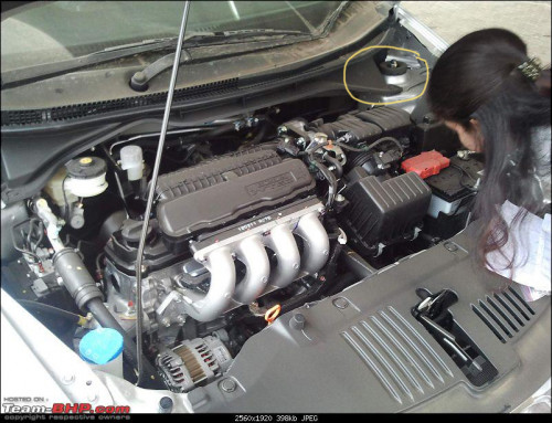

QUOTE(AllnGap @ Aug 4 2019, 01:51 PM)
yes, open engine bay, see those strut mount on top of front wheel, spray those. (left and right side)
if those struts are compromised kawkaw, the moment you brake, you can feel your car twist (or unstable).
Funny
When the absorber top mounting got noise, it means it is loose. Worn out. Not suppose to have movement.
Just change it.
