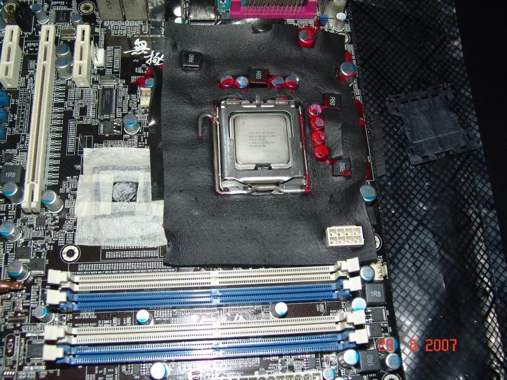

The day started with coolice, irangan and me wondering around KL looking for DI insulation material. From Mid Valley to Subang, to Jalan Ipoh and finally we got all the stuff prepared. lolhalol assisted on getting some sources and we do the buying.

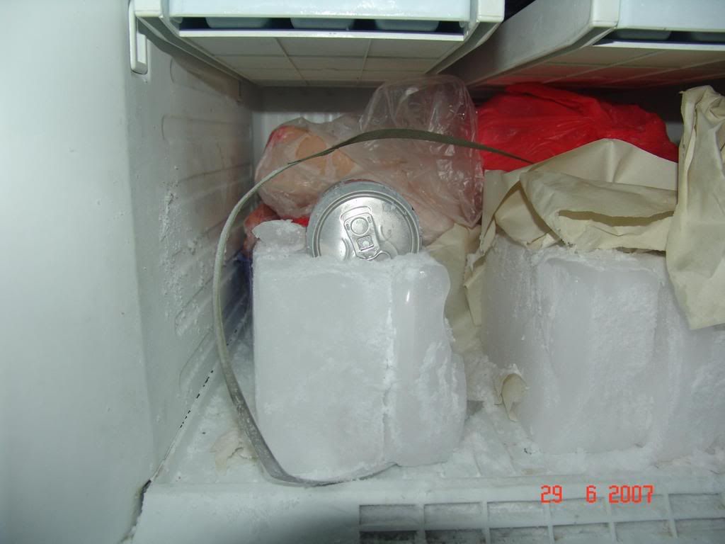

Once we reached lolhalol house, coolice was kinda worried that the DI would melt. Luckily lolhalol refrigerator was big enough to fit in all the DI. Then lolhalol and me were grumbling for dinner as all of us haven't settle for dinner yet. But coolice insisted to run the DI Benching first thinking the DI would melt. So there goes our dinner.
The DI, Dry Ice, CO2

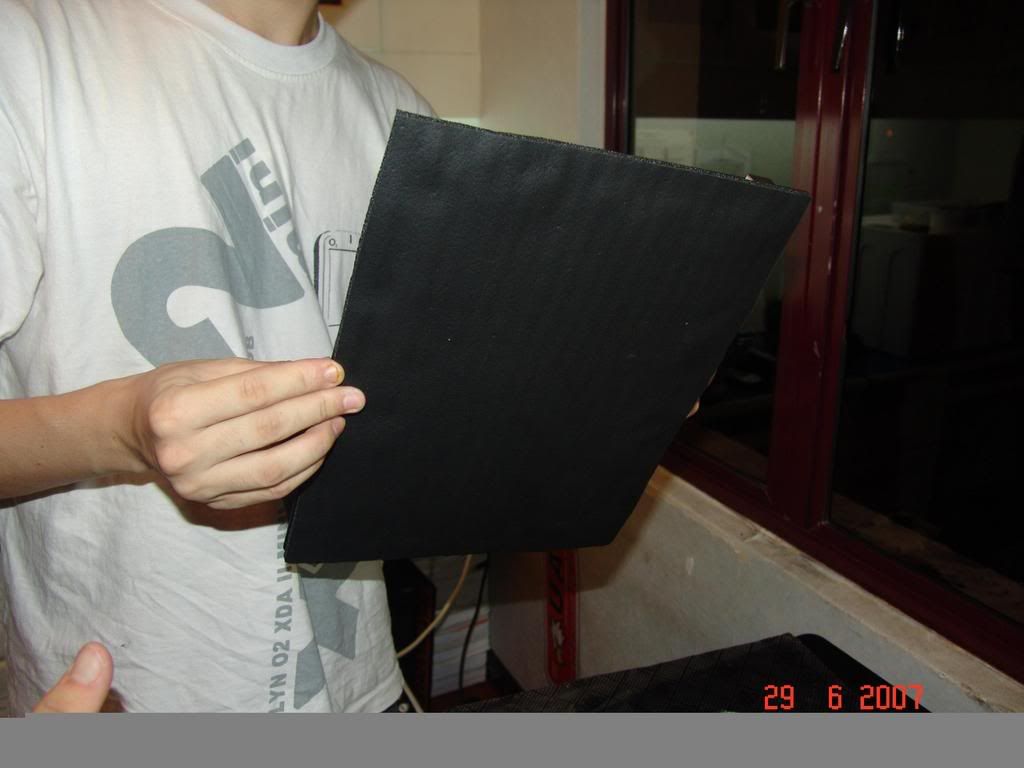

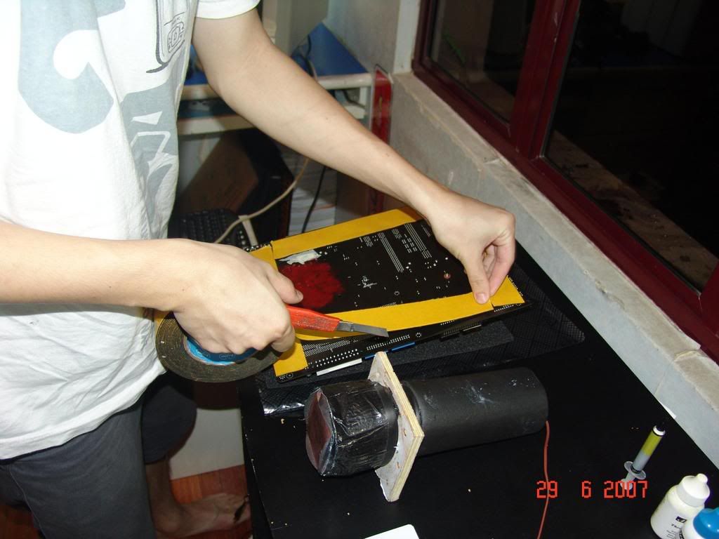

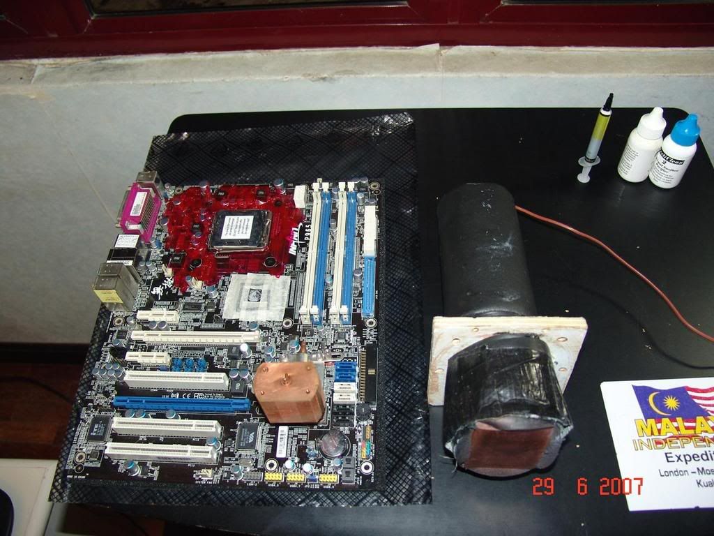

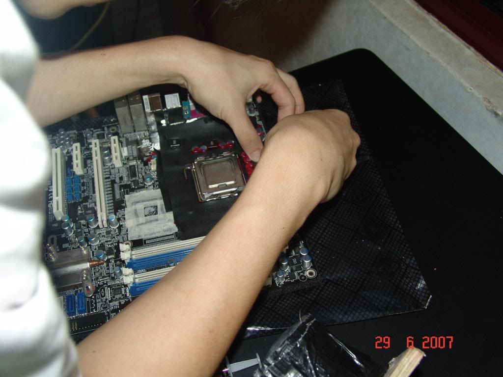

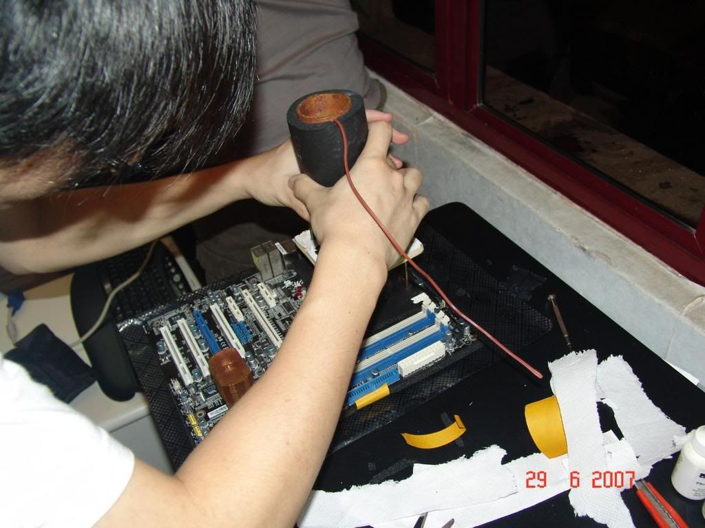

Insulation Process

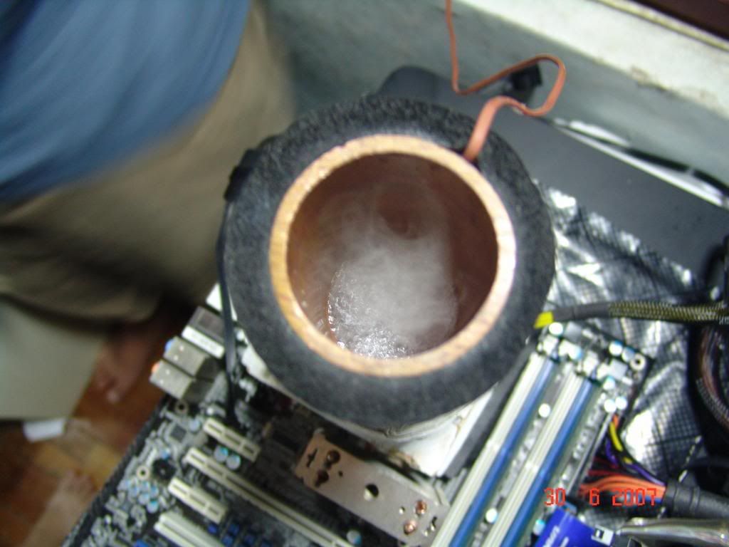

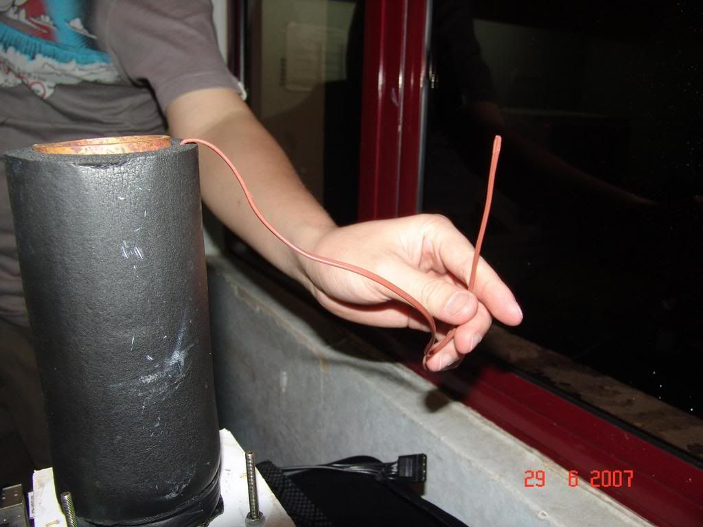

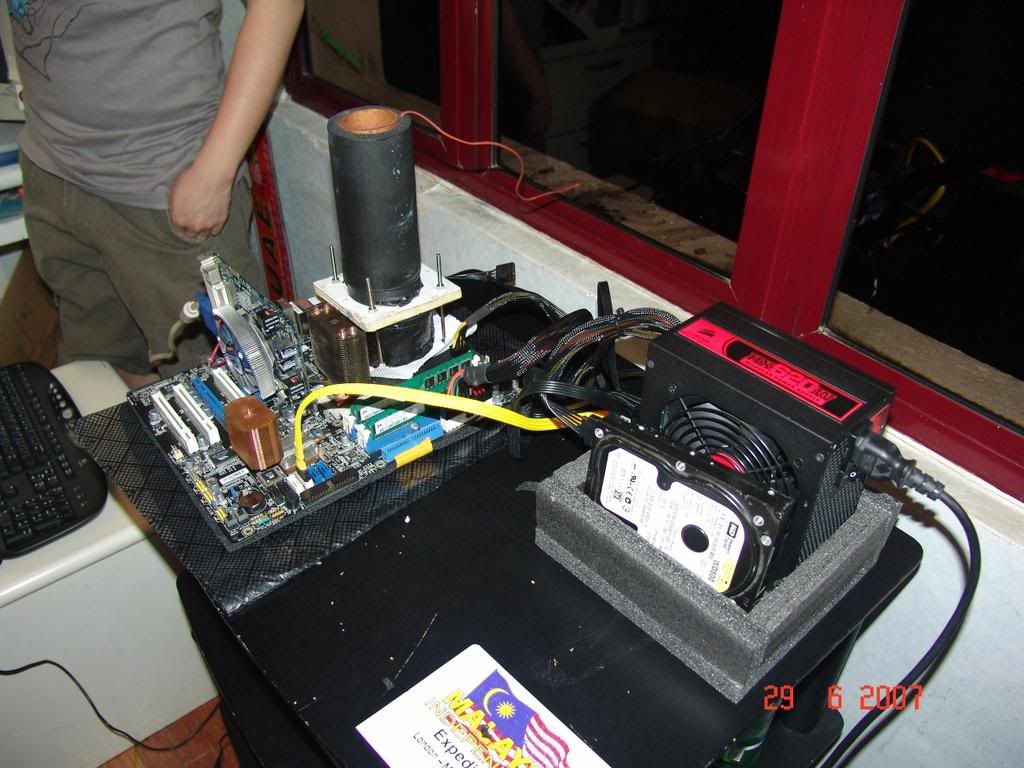

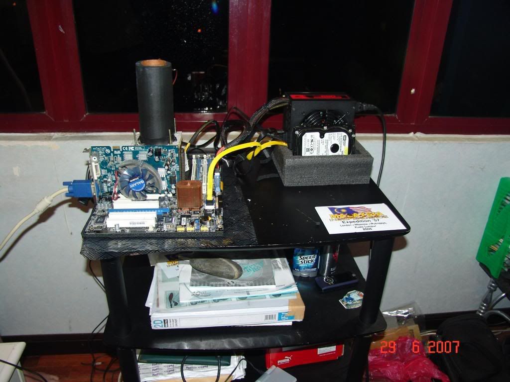

Mounting 'Shamino Pot', First Try
Where is our Thermometer?
Here you go! We had not enough time to go Jalan Pasar to get one.

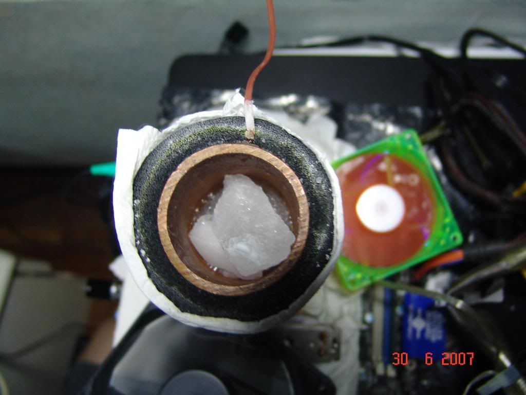

The DI after around 1 Hour
Look at the Shandy! It was 'Rock Solid Stable'

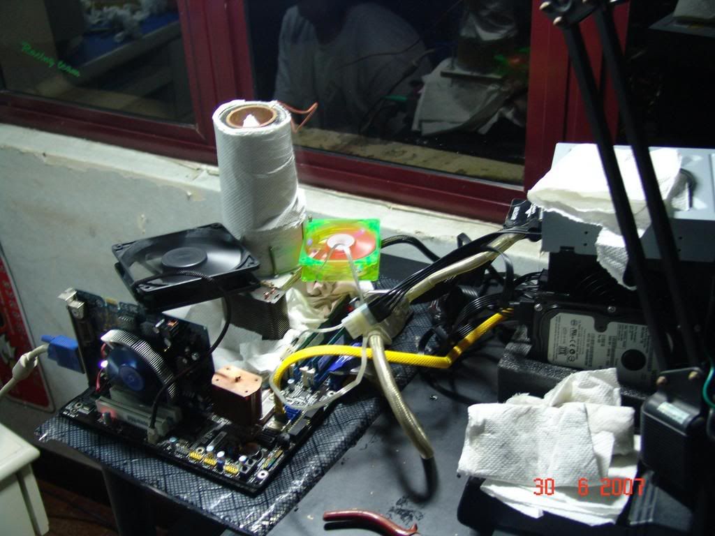

The first processor we tested was an E2160 which we bought it from rlhc17/raymond. Surely we do remember that the processor can be tuned up to 100% OC under WC. However, Extreme Cooling was not helpful. We couldn't bring it up any higher than we did before under coolice WC. So we were quite upset with the outcome.
Testbet 1
CPU : Intel Pentium Dual Core E2160 1.8GHz
Motherboard : DFI Infinity P965-S
RAM model : Micron OEM D9GKX DDR800
RAM capacity : 512MB x 2
HDD : Western Digital 80G
PSU : Corsair HX620W
VGA : Nvidia Galaxy 7300GT
Cooling : Dry Ice
OS : Windows XP
E2160 under DI - 01
E2160 under DI - 02
E2160 under DI - 03
2 Sifu Trying for the Best!

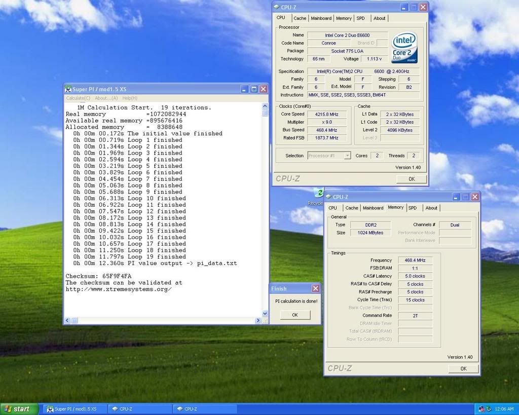

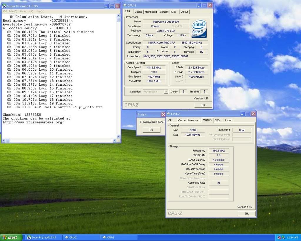

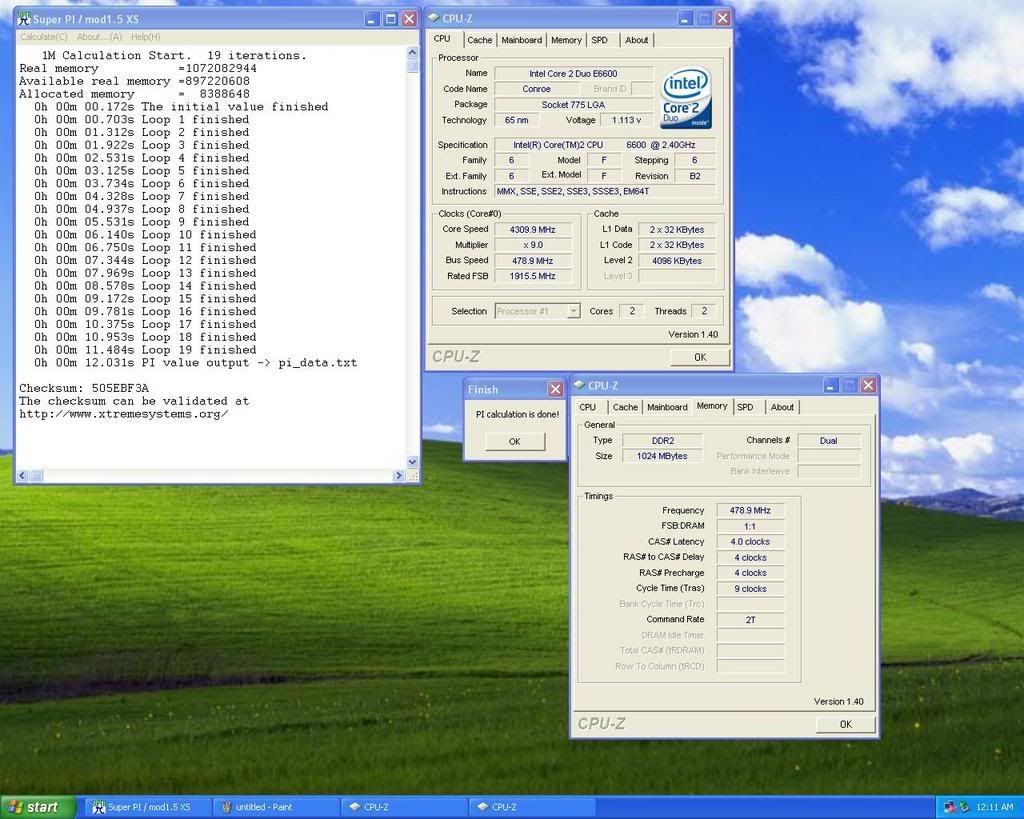

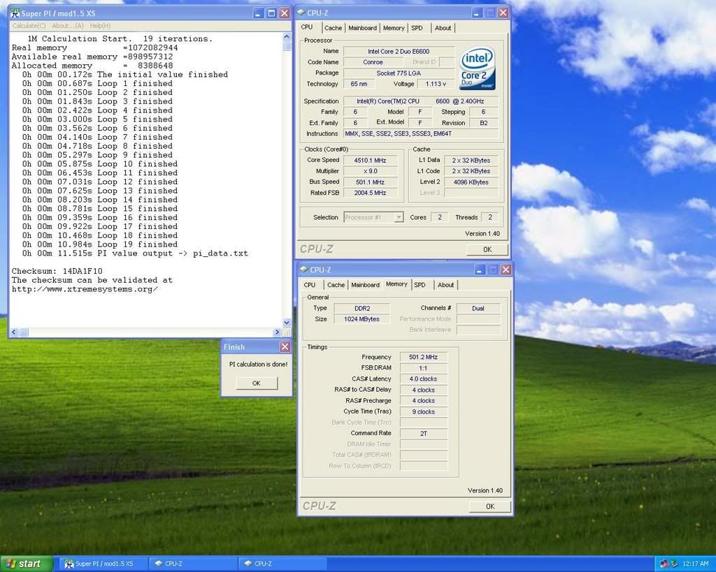

The second test is on coolice's personal E6600. Everyone of us was hoping to break our own Lowyat.NET Super PI 1M record. Finger crossed.
Testbed 2
CPU : Intel Core 2 Duo L629B364 E6600 2.4GHz
PUS : Corsair HX620W
Cooling : Dry Ice
OS : Windows XP
4.215GHz 468x9 1:1 5-5-5-15
4.309Ghz 478x9 1:1 4-4-4-9
4.413Ghz 490x9 1:1 4-4-4-9
4.501Ghz 501x9 1:1 4-4-4-9

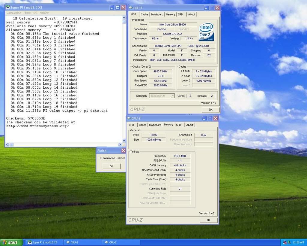

During OC-ing coolice E6600, it was very very exciting. coolice was tweaking and at the same time worried about the DI. Both me and lolhalol job were to 'take care' of the setup so that nothing goes wrong. We were monitoring the DI while coolice was trying to tweak higher. The E6600 was easy reaching 4.6GHz. But we hunger for more.
Anyway, when coolice managed to OC to 4.62Ghz, his Super PI score already overtaken kcnyc's 11.359s with his 11.235s achievement.
4.620Ghz 512x9 1:1 4-4-4-9

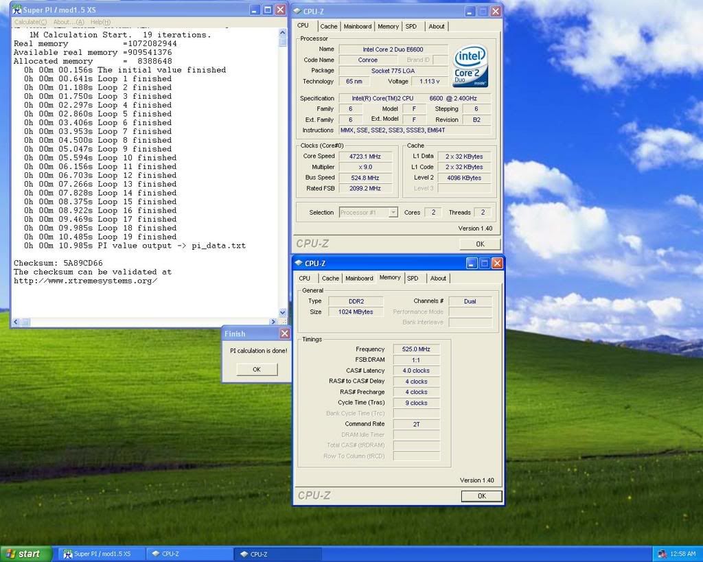

After looking at the Super PI 1M score, we thought that we might as well break the sub 11 barrier for Lowyat.NET forum. So here goes.
4.723Ghz 525x9 1:1 4-4-4-9
4.725Ghz 525x9 1:1 4-4-3-9 (Memset Tweaking)

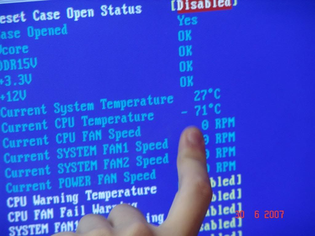

Once irenic arrived, coolice did the insulation on the Gigabyte P35T-DQ6 DDR3. It was not as easy as DFI Infinity Dark because of the huge chipset heatsink. coolice wasted around 2 hours for the insulation. Once everything was up and ready, we eagerly check the Gigabyte P35T-DQ6 DDR3 PC Health for Tempreture because DFI Infinity Dark couldn't read subzero temps. Check it out!
-71 Degree
At that time it was already 6AM in the morning and we don't have much DI left. So immediately we OC the Gigabyte P35T-DQ6 DDR3. To our shock it didn't even boot at 4.2Ghz. After doing some tweaking and changing the ram slot then we managed to get a 4.5Ghz OC. Then immediately we run PCMark05 but it keep on hangs. After an hour or so, the DI supply was all finished. Therefore we couldn't do anything but to stare among ourselves that we already tried our best. We thought that we couldn't at least do a 4.6Ghz PCMark05 to summit for the Gigabyte OC Challege. That's the sad ending for us and straight away we all 'fainted' in lolhalol house. irenic was the most comfortable one on the bed.
