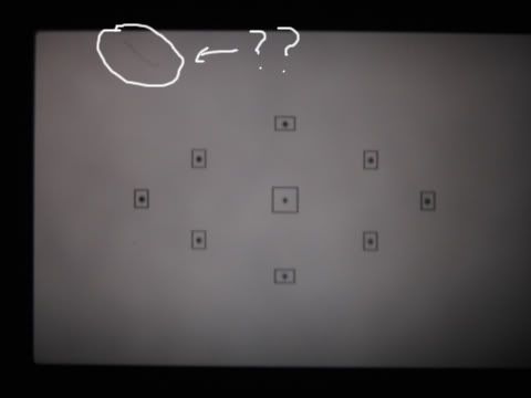

Whenever I look through my viewfinder, I see some sort of black hair.
However, when I take the picture, everything is fine.
I tried removing it but it still remained there.
However, when I take the picture, everything is fine. I tried removing it but it still remained there. |

Probably some dusts got stock on the mirror....remove ur lens and check the mirror and blow the dusts away. Somtimes, they can also get stuck behind the view finder cap...do the same thing.

what camera are you using and what does the "black hair" looks like? is it just a straight line from bottom to middle or another line?

QUOTE(AlamakLor @ Jun 30 2007, 03:02 AM) Probably some dusts got stock on the mirror....remove ur lens and check the mirror and blow the dusts away. Somtimes, they can also get stuck behind the view finder cap...do the same thing. Do you have any guides with images?QUOTE(rezzz @ Jun 30 2007, 03:11 AM) what camera are you using and what does the "black hair" looks like? is it just a straight line from bottom to middle or another line? I'm using a canon eos 400D, its at the top left of my viewfinder.QUOTE(xandman @ Jun 30 2007, 06:02 AM) Nah, its not an eyelash. I confirmed it with my friend looking into the viewfinder.This post has been edited by [ - i l l u s i o n s - ]: Jun 30 2007, 10:20 AM |

744 posts Joined: Jan 2003 From: Brisbane, Australia |
QUOTE(AlamakLor @ Jun 30 2007, 10:50 AM) you wont need a guide. Just remove your lens, look at the piece of 45 degree glass. blow the dusts away or use a lens brush to get rid of them okay. anyway here's a pic of my view finder.![]() This post has been edited by [ - i l l u s i o n s - ]: Jun 30 2007, 10:56 AM |

QUOTE([ - i l l u s i o n s - ] @ Jun 30 2007, 10:18 AM) Do you have any guides with images? You need a guide to use a blower?? I'm using a canon eos 400D, its at the top left of my viewfinder. Nah, its not an eyelash. I confirmed it with my friend looking into the viewfinder. Added on June 30, 2007, 10:20 am Guides please? or there already is one in the forum ? As for using CCD cleaner swabs, you can g-o-o-g-l-e. |

it seems too fine to be a hair... probably dust.. i had the same problem with my 350D earlier, and it is dust trapped under the focus screen, no matter how i blow or wipe the surface of the focus screen, the dust will remain there, then i took the courage to remove my focus screen to clean it..
refer to this pdf on how to remove the screen, it was meant for 20D, but i found it to be the same for my 350D, and should be the same for ur 400D too.. http://www.katzeyeoptics.com/files/KERR-20D.PDF do it at your own risk. if u're not confident, then send it to a shop and ask them to do it for u.. |
