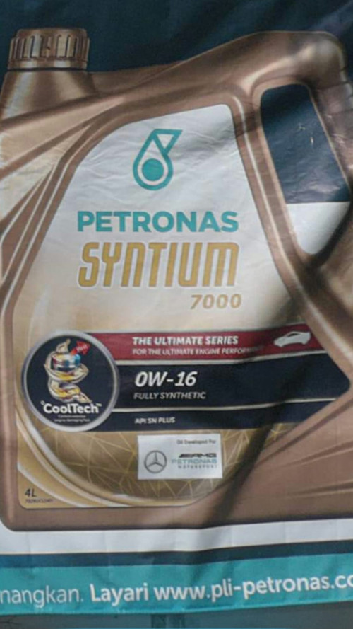

 PETRONAS SYNTIUM 7000 ULTIMATE SERIES, 0W-16
SUSIkmal404
post Jul 15 2019, 08:45 PM, updated 7y ago
4 posts
Joined: Feb 2019
First time see 0W-16
What car use this oil?
This post has been edited by Ikmal404: Jul 15 2019, 08:59 PM
RicoT
post Jul 15 2019, 08:47 PM
200 posts
Joined: Feb 2009
Next standard API SP promote 0W-16, the shield logo. 0W-20 and above use starburst logo.
Now API SN and SN+ promote 0W-20.

Layari pli.petronas.com

crazy, what engine uses such light EO
it's like no protection at all

Maybe for hybrid?
I don't know.
Turbo can use this or not

turbo especially cannot use such light oil

Now new jap car all use 0w20 dy

LL series?

0W-20 already extremely light..they use on hybrid
0W-16?...fuuuhh....it's like 0W-15 is too light, so they make is +1 to 0W-16 for to be the lightest

Problem is 0w20 ia not well suited for very hot country like us
It wi become too thin when ambient temperature over 35 degree

If the owner's manual recommend minimum 5W-30, then that is the eco drive level. If you heavy footed, i.e. zoom here and there, use the next level up, which is 5W-40. Over time, piston ring will get worn out if you zoom a lot with 5W-30 and starts to consume engine oil, move to 5W-40. If it is getting worse, then it is time to overhaul.
Civic 1.5T if no heavy foot, can use 0W-20. If rev redline a lot, use 5W-30.

higher viscosity is always better protection to the engine
that's why i say this 0W16 is like no protection at all
QUOTE(SonnyCooL @ Jul 15 2019, 09:17 PM)
i cant brain now
no need to brain
the grade doesn't make sense to begin with
engine is +10 in increment....20,30, 40, 50

Newer engine can accept 0W-16, tolerances between cylinder wall and piston ring is smaller due to the use of aluminum block and improve manufacturing technique. Also, new additives in engine oil helps with sheer resistance, which keeps the oils film intact, hence enabling the use of lower viscosity engine oil.
Google up API SN+, API SP or ILSAC GF-6 and engine LSPI protection.
Of course if engine are manufactured to suit 5W-30, cannot use 0W-16. 0W-16 is quite a new engine oil viscosity standard, I doubt Malaysia needs something like this since emission is not our concern, still using Euro 2M and 4M petrol. Why bother with emission?

GF-5 = 0W-16
GF-6 = 0W-16 or 0W-12
GF-7 = 0W-8(?)
i believe more toward these manufacturers are coming out with lighter and lighter oil
so that engine wears out faster so u can faster go repair it or buy another car

It is all about efficiency and conforming to emission standards, all car manufacturers need to achieve the same goal, so all will come out with the same type of engines using newer engine oil. If you feel car manufacturers are scheming as such, then no need to buy new car. Except for hybrid, low pressure turbo, Mazda Skyactiv-X, there is not much breakthrough in engine technology to reduce emission standards. So, manufacturers are also depending on new lighter engine oil to achieve their target.
Engine wear is dependent on owner how they maintain it and drive it. If drive like race car, sure will break down sooner. Different drive style, different scenario, different needs, different engine oil.
Long track racing, heavier better because less volatility at prolong high engine temperature. Drag racing, lighter better, because zoom a few seconds and stop, light engine oil reduce viscous oil film drag on piston. Regardless of it, after race, these race cars will change their engine oil. If normal car drive like that, sure gg sooner as normal people don't change engine oil often, sticking to 10,000km change while drive like maniac.
5W-30 were introduced in 1980s, the people back then also skeptical about it. Now, 0W-20 is the new norm.

amg confirm
