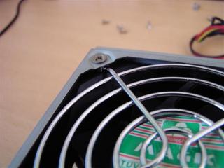

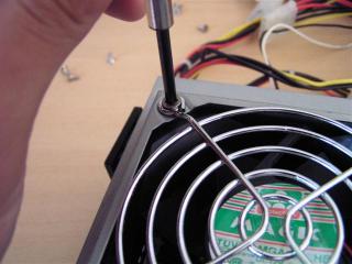

Here I'm cleaning a psu with a 80mm fan, but the size and position of the fan doesn't matter, as long as it has a grill on the outside are true. First remove 3 of the 4 screws from the PSU.
Loosen the remaining screw slightly, BUT MAKE SURE IT DOES NOT COME OUT or you'll have hell trying to screw things back. Then move the grille out of the way.
Clean the PSU with a brush or air spray, paying attention to the fan and heatsinks. Turn it upside down after you're done to let the loosened dust fall out, blow if the dust gets stuck.
Screw everything back as it was. If the fan keeps falling in when you screw, loop a piece of thread on one of the support arms (that connect the frame with the centre motor) to support the fan.
You're done! This method is relatively safe, as it will be hard to accidentally touch something in the PSU which might be electrified. Although a better job can be done if you open up the whole PSU, that would surely void your warrany.
