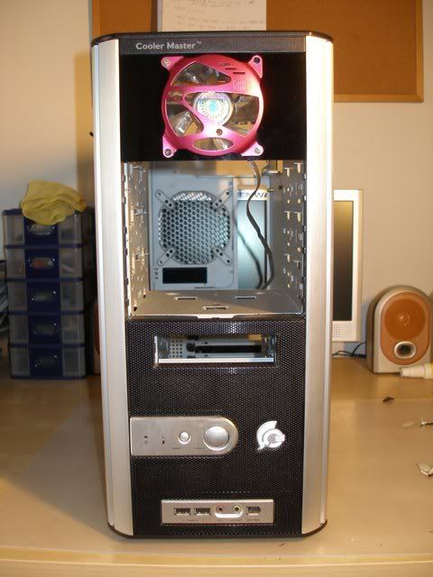

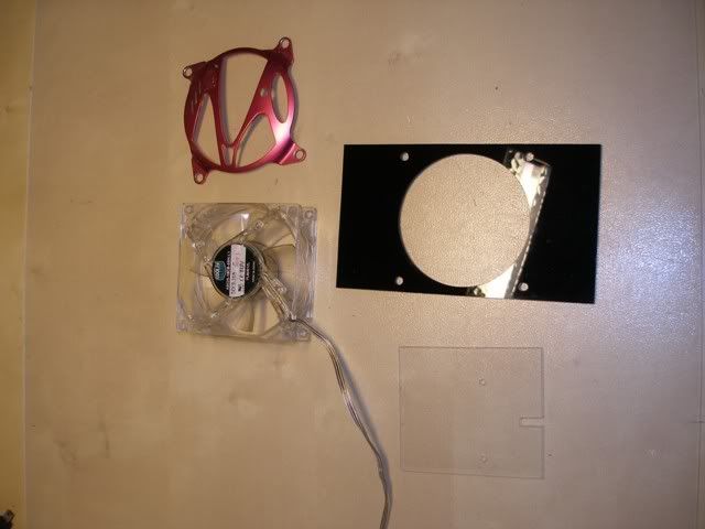

Here's the front intake mod. Cut an acrylic plate for the 80mm intake fan.

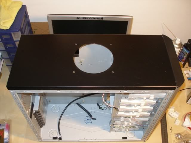

Top 120mm blowhole.

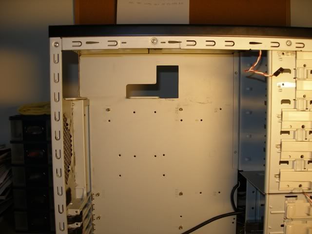

Mobo tray mod for wire management.
Intake mod all done. The fan plate is installed using the stock Coolermaster slide locks. Just slide the plate inside the ROM slot, slide the sliders forward to lock the plate in place just like a normal ROM device n ur done. It can be placed anywhere. I put it at the top in this pic but it can also be placed lower down.

How do u keep the "front panel" fan intact to casing?
solder to front casing?

Just slide it in n lock it in place using the stock slide locks on the case.
Same method as sliding in the DVD ROM n locking in place with the locks.

actually i think its better to put the fan on the bottom 2 bays...
putting it on the top 2 bays pretty useless IMHO. coz the amount of air being pushed in by the fan will prolly be sucked out by the top 120mm blowhole before it can get anywhere tongue.gif

Haiyaaaaaa the picture shows the front intake at the top 2 slots because I put it up there so I can do the final fitting to make sure everything fits perfectly. The top 2 slots r used for that so I can c if the front plate is totally flat with the front of the case only. After that I forgot to put it down at the bottom for final placing. smile.gif
