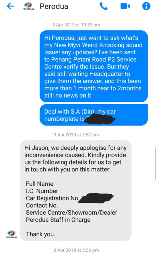

QUOTE(faiz5200 @ Aug 2 2019, 09:51 AM)
My car make noise when going certain speed. Around 10 -20 kmh but mostly happen when reach 50-55 kmh. The noise is like metal hitting on something. I think it comes from the dashboard.
Already sent to SC. They said the noise not coming from dashboard but coming from outside. Around the cowl(wiper area). I thought the noise already gone but still there the next day im driving.
Dont have time to go there again since SC only treat noise complaint during weekday only. Weekend only for service.
Anyone got the same issue and manage to fix it?
Please ask them to check on Steering Rack n Front Coil Spring. Theee what i had done, after reppaced n fixed perfectly. No more those metal hitting weird sounds

QUOTE(twc0608 @ Sep 30 2019, 10:05 PM)
Sifus~~~~
Any owner or sifus faced the rattling/squeaking noises from driver side door panel or door trim? Top right side which near to the window there?
I have went to SC dozensss of times and they said no noises can be heard (I guess they are deaf!); installed Vibramat; ensure all door clips inside door panel are locked on the spot......
And yet the noises still there..... the "tik tik tik" or metal hitting sounds which appear whenever driving on bumpy or uneven road.....
Any sifus know which part of the body or door panel that is creating the noises and any solution??
Helps ~~
T.T
It's from Rear coil spring and steering rack noise. P2 Petani Road SC know bout my case. U can refer me.

QUOTE(faiz5200 @ Jan 24 2020, 09:53 AM)
Hi, I also got this issue but not sure if it the same with you or not. The sound is like metal hitting on something multiple times. Sound may come around the dashboard. Only happen when drive around 50-55kmh. It disappear after pass that speed or if I press the pedal hard. Sometime I heard it when drive slow around 20-30 but the sound is minimal. Already check with SC before but they cant find the cause.
I will try mention to them what the foreman told to you next time I go to SC. Thanks.
The metal sound is from Drive Shaft and Front Coil Springs. Done my claimed from P2 SC Petani Road. That weird sound is disappeared after fixed.

QUOTE(wayton @ Jan 31 2020, 10:31 PM)
They fix or replace what part then?
Replaced Drive Shaft and repair the coil spring.

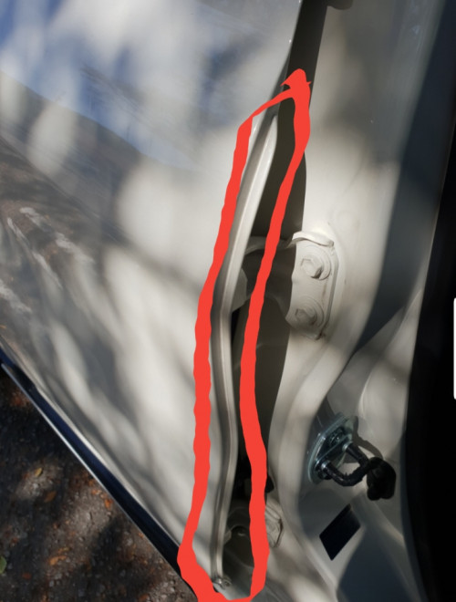

Maybe you guys can try it out on B-Pillar if you feel that you can hear noise from outside… mine very satisfy after do both front doors.

For those who hunt answer of Soundproofing for MG3… Tried to get a B Pillar Rubber… U will noticed the NVH improved alots… im one of the VibraMat customer, but yet VM not as good as i put B Pillar Rubber.

QUOTE(lonelymac @ Jun 12 2020, 10:41 AM)
i told subang service centre about this.. they told me the UR bar causing this problem.. they ask me to remove it and try again.. hmm...
also reported noise coming from rear left passenger (above triangle mirror).. they said they received same case from 1 customer and reported to HQ, until now no feedback no solution.. im the 2nd customer report the same issue..
I do reported thru their Service Center but kinda slow response.. So i decided go to Perodua Malaysia FB n make a report over there... Within less than 48hours, the Petani Road SC called me on the matter and make replacement of my Steering Rack and do some adjustments on my existing front Coil Springs.
Give a try on their official FB… Hopefully this will help you out...
