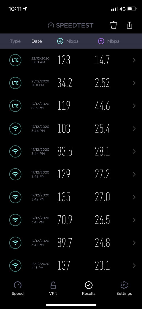

After 5 days using it, I can say that I can get higher upload speed as you can see from my speedtest below. So much better than my previous TP-Link M7350
Not sure on how to get the signal to lock but will test it out again.

Looks nice! Which package broadband u subscribe?

Using a multi SIM for data only connected from my Maxis Postpaid plan. I think the 4G+ really helps instead of just normal 4G

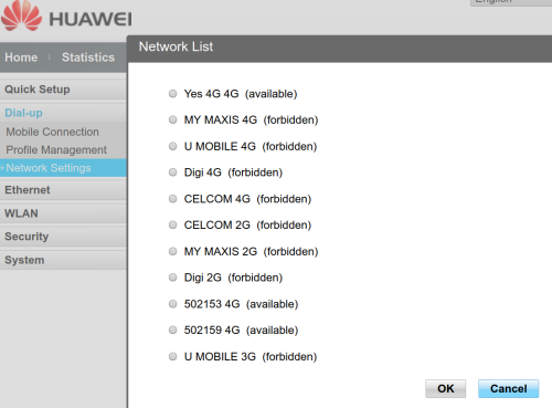

JLA
post Dec 8 2022, 05:22 PM
2,792 posts
B315s-607
502159 4G some said DNB 700mhz b28
