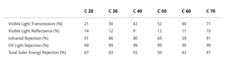

For front windscreen, the TSER value between C40 and Sech60 is very close, just a 1% difference. But Sech60 VLT at 59% is higher than the C40 VLT which is at 42%. It is risky to use C40 on the front windscreen as the VLT is low at 42%, and since there isn't much difference in TSER between C40 and Sech60, personally there isn't much sense using C40 for the front windscreen when you can opt for Sech60. Am I missing something?

The Tables below taken from Huper Optik website. You can compare on the VLT and TSER of the C40 and Sech60. The difference in TSER between C40 and Sech60 is 1% which is negligible.
