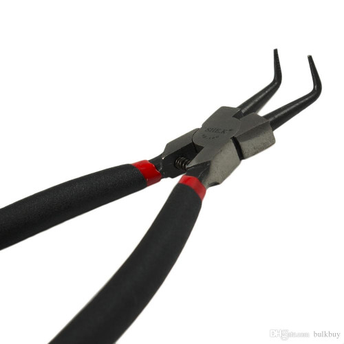

Drill two small holes into the nut
Use the 90 deg bent needle nose pliers to crack it off
