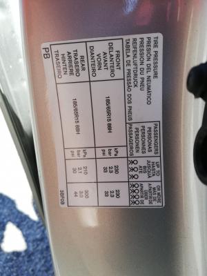

TSBravoZeroTwo
post Apr 5 2019, 11:11 AM
1,128 posts
Joined: Jul 2012
QUOTE(zeng @ Apr 4 2019, 11:27 PM)
Does the user manual or placard shows tyres being H, W or Y tyre  AND is the Load Index 88 or higher?
What about a picture of your pillar placard ?
Please find attachment. Thanks.
zeng
post Apr 6 2019, 10:05 AM
1,810 posts
QUOTE(BravoZeroTwo @ Apr 5 2019, 11:11 AM)
So it says 88H tyres clearly on pillar placard.
Hence, you'd correctly used the 88H tyres here.
As to recommended tyre air pressure:
280 kpa would be in compliance with tyre manufacturers/Standards Organisation, OR
300 kpa would comply with car OEM (???*which had no professional basis ,in a way) but non-compliance with tyre Standards Organisation.
This post has been edited by zeng: Apr 6 2019, 10:15 AM
zeng
post Apr 6 2019, 10:12 AM
1,810 posts
QUOTE(BravoZeroTwo @ Apr 4 2019, 09:27 PM)
In this case, how much kpa should I inflate my rear tyres ? Thanks.
IMHO, 280 kpa in compliance with tyre Standards Organisation at maximum load of 560 kg/tyre.
At 300 kps- it's non-compliance with tyre manufacturer/Standards Organisation AND it isn't designed for loads higher than 560 kg.
