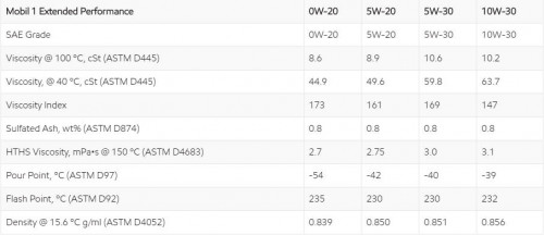

There is a difference between 0W or 5W at operating temp e.g. 100 degree C but its very small we probably wont feel it. The cold performance is more significant in this case but this applies more to winter.
For example, this is Mobil1 FS EP range spec sheet
