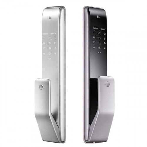

US $368.39 5% Off | Xiaomi Youpin M2 Smart Lock Automatic Fingerprint Sliding Lock Fully Automatic Push-Pull Smart Remote Control For Mijia APP https://s.click.aliexpress.com/e/csjkBHoy ![]() |
Mar 23 2019, 11:30 PM
#5
1,203 posts Joined: Jan 2003 |
Xiaomi products are at good value for home iot range but frequently very buggy and unreliable.
For door lock, I prefer to look for other more reputable brands. This post has been edited by Snoy: Mar 23 2019, 11:31 PM |

![]() anybody installed this Mijia Smart Lock? It's the cheapest I found. Previously selling only Rm999 https://www.lazada.com.my/products/original...3JvLvo&search=1 These smart locks, they cant lock by themselves right? This post has been edited by idoblu: Mar 28 2019, 08:07 AM |
