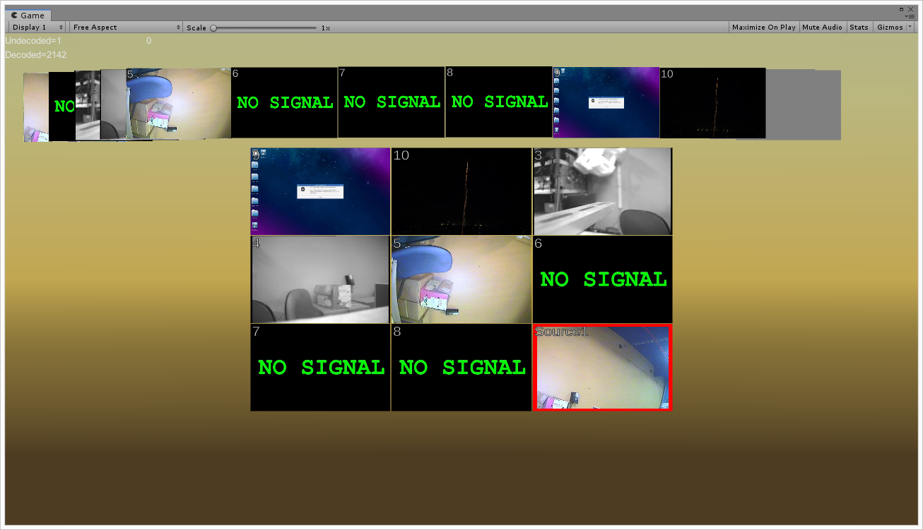

I am not sure if the terms i use will be correct, i am very inexperienced in shader, i found some code online and changed them so i able to use them. The code below should draw a red border over an image and the border thickness should be 3% off the image width and height. so with bigger image, the border will increase in size and also decrease if the image become smaller. I want to change that behavior of the border, instead of 3% of image width and height, i want to change to a fixed 3 pixels. Any idea which direction or how should i do it ?

instead of the shader decide on the size of the border, the app tell the shader whats the size of the border it supposed to draw. so the shader dont make the decision.
