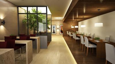

How bout this rendering? Pls give some comments.

Very nice thumbsup.gif Looks quite cosy. I like interiors in light colours. Keep it up!

very nice bro, much better than mine

This is purely my personal preference. Since both of you do have natural light source, why not emphasize more on that rather than using artificial light? The renders are indeed look gorgeous, but I think can be improved more if you let natural lighting as primary source and artificial as supplementary lighting. Using too much artificial lighting makes it look, well, unnatural. Best example is IKEA renders, where they mainly using natural lighting as primary light source.
For TS, its okay to cheat and use parallel projection for most shots. But in some cases, you do allowed to pitch down the camera, but not lesser than -3°.

Yea a lot of fake lights there, and very noticeable, you can see them all in the reflections.
If there option to make those light sources "not affect reflection", make sure to enable that option.
Try crank up the ISO instead, so you can compensate with weaker fake light sources.
Or better yet, don't even make any fake lights. See all those ceiling lights? They aren't even properly utilized.
You try to cheat those ceiling lights with long strip of rectangular/planar light, I can see that laugh.gif
