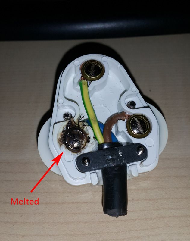

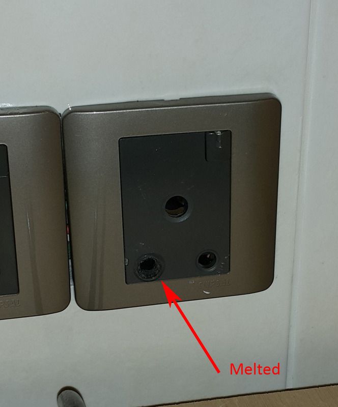

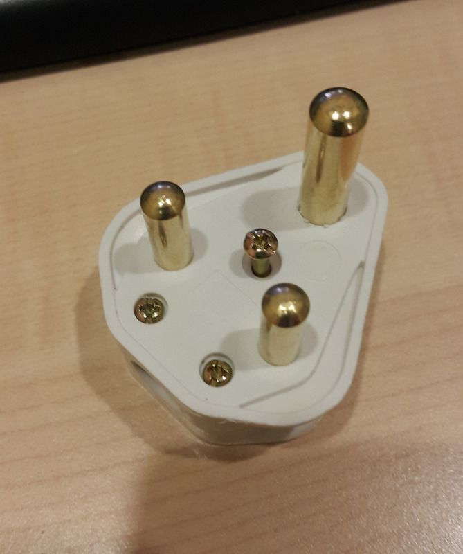

I swapped my built-in oven today and when removing my old oven, I noticed that the plastic around one of the legs on the power plug had melted and stuck onto the socket. Took some effort but after prying the plug out from the socket, this is what I see.
Any idea what happened here?

Poor contact pressure between the neutral connections making electrical arching like welding. Common failure thus very important to have full contact on all connections especially high amperage devices.

Arching.
Basically the neutral terminal at the plug is not tightened properly or got loose with time due to heat.

Thanks guys. Just checked some articles online as well and yeah, it seems that it is likely due to arcing. Have to be very careful when I replace the plug to make sure it's well fastened, and that there is no exposed wire that may lead to arcing. This could have lead to a fire.. thankfully it did not.
Will need to replace the wall socket as well.. hopefully, no nasty surprises when I open it up.

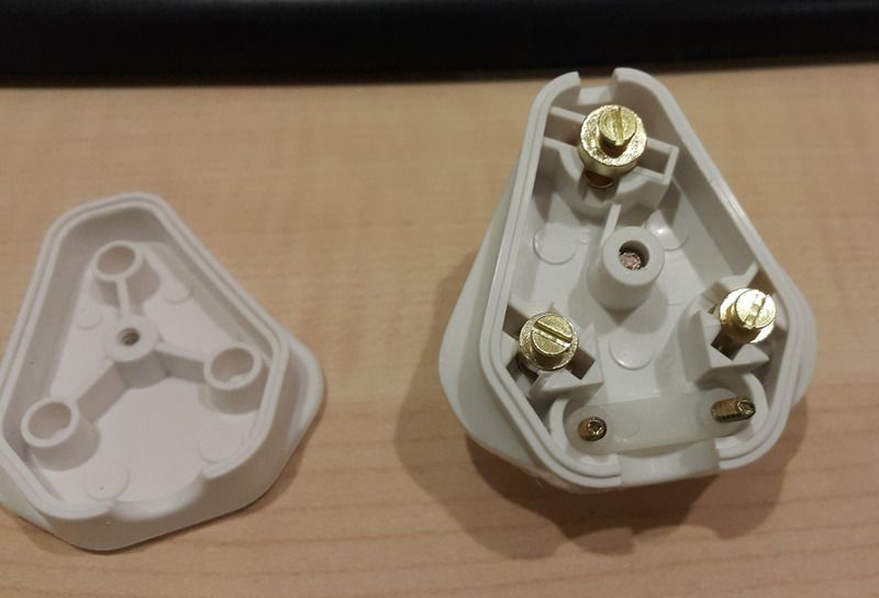

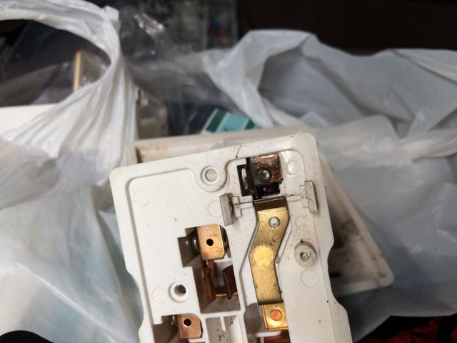

The house socket have a limited current spec. In this case 15A. So how good quality it is, it still limited by the current spec.
If the oven is running almost 15A, it reach the wall socket and plug limit. It still alright with short time running.

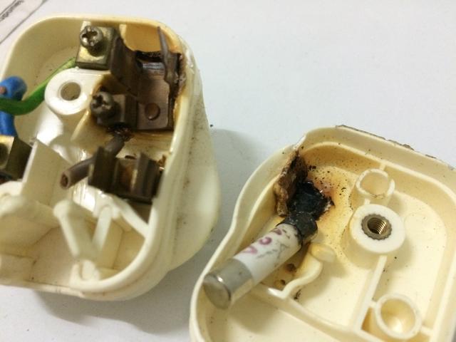

But if running at 2-3hr or whole day ovening when festival time, that is what happening in the pic. That MK plug is already very good quality with that small melt area only. It is a UK brand.

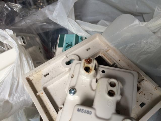

Here is my plug melting. Quality is much worst than the MK.
This is the Schneider wall socket in the kitchen running at high current for long time.

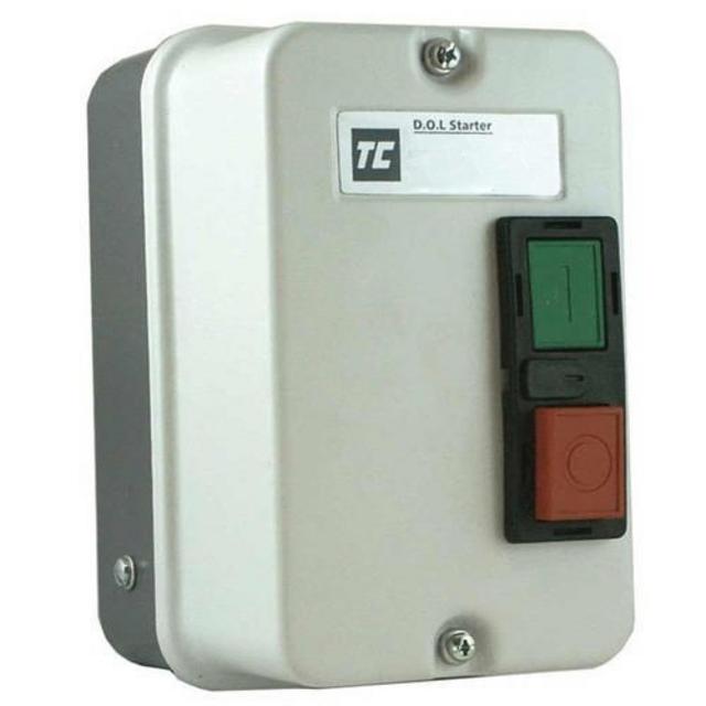

If you really want a safer longterm switching connection, DOL starter unit (direct online starter) which normally use on the aircon or water pump is better.
A 32A DOL starter is more than enough. But the oven wiring is permanent screw into the unit. If you want to take the oven away, you have to unscrew the wire out. ( it is the best connection for high current device)

You should use something like this - industrial plugs/sockets rated at higher amp (32A recommended) for high load
http://www.profactosolution.com.my/product...ll-Mounted.html
