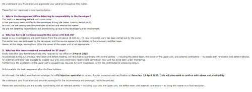

69ers
post Apr 9 2025, 09:00 PM
25 posts
Joined: Oct 2021
QUOTE(butthead76 @ Mar 26 2025, 06:17 AM)
why MO refuse to issue Form 28? Where is the actual leak?
This is their reply
69ers
post Apr 9 2025, 09:01 PM
25 posts
Joined: Oct 2021
QUOTE(69ers @ Apr 9 2025, 09:00 PM)
This is their reply
We understand your frustration and appreciate your patience throughout this matter.
Please find our responses to your queries below :
1. Why is the Management Office deferring its responsibility to the Developer?
This leak is a recurring defect, not a new issue.
It had previously been rectified by the developer during the Defect Liability Period (DLP).
As such, we are liaising with the developer to revisit and resolve the matter.
We are not deferring responsibility but are following up due to the developer's prior involvement.
2. Why has Form 28 not been issued to the owner of B-03A-01?
Based on our investigations and confirmation from the unit above (B-03A-02), no new renovation work has been carried out by the owner.
The earlier leak was addressed by the developer, and the source appears to be related to the previously rectified issue.
Hence, at this stage, issuing Form 28 to the owner of the upper unit is not appropriate.
3. Why has this issue remained unresolved for 37 days?
Kindly note that your formal email was only received by our office on 3 March 2025.
As explained during our previous renovation and defect meeting, we have had to coordinate with several parties — including the defect team, the owner of the upper unit, and external contractors — to assess both renovation and defect histories.
An external contractor was engaged to inspect your unit, and preliminary repairs were carried out. Your unit has since been under monitoring.
Furthermore, the availability of the upper unit’s occupant was required for joint inspections, which has contributed to scheduling delays.
Unfortunately, the leak reappeared after the Raya holidays.
As informed, the defect team has now arranged for a PU injection specialist to conduct further inspection and rectification on Saturday, 13 April 2025. (this will also need to confirm with above unit availability)
We understand your frustration and sincerely apologize for the inconvenience and prolonged resolution process.
Please rest assured that we are actively coordinating with all relevant parties — including your unit, the upper unit, the defect team, and external contractors — to bring this matter to a final resolution.
butthead76
post Apr 10 2025, 06:34 AM
1,498 posts
Joined: Jun 2012
Long process as involved so many parties especially developer. They need developer approval the way forward, then arrange with unit and contractor. Also long holidays made it bad too.
I sometimes having coordination headache too even dealing with management, contractor, unit and tenant. Till you coordinated 1 time of such incident you will know the difficulty. Will be even worst if the unit is tenanted then u add in another party the owner to the coordination. Also, if the owner or tenant not cooperative.
