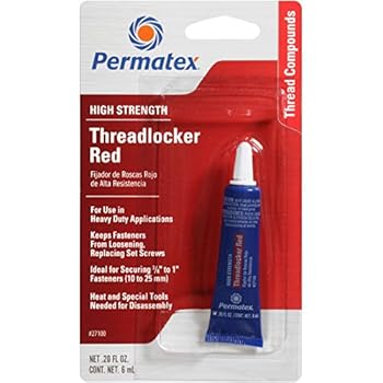

For future ref: those screw/nut who prone to loosen due to vibration.. put the Loctite thread locker when screwing in...
Experience riding HD gives the magical essence of the bolt and nut Thread Locker..

QUOTE(jaylim94 @ Jul 9 2018, 08:37 PM)
All good workshops should have Loctite.
