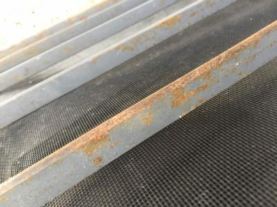

My main door grille is but a small example....It's powder coated ...too thin I discovered later...and parts of it is rusting.
Another grille maker later told me need to sand out the rust, add primer and then respray back.
am looking for the exact Dulux spray (Dawn Gray) ...know where i can get it in PJ/KL? Have checked with a few hardware shops but they have Nippon and Jotun colours that are not matching.
Is there such a thing as powder-coated spray in a can that you can buy off the shelf?

if its rusting like that.. better one shot change color and paint them all again. use normal paint brush to do it, and buy a easier to source color.
before paint, you can sand it with coarse sand paper. this will last you for the next 10 years. if no sanding, maybe one year later u will see dark spot. coming out.

You can get the Dulux Gloss paint at those colour customise hardware/paint shop. Is a gloss paint, then up to you whether you want to spray, brush or roller on the gate.
Powder coated spray, as i know there is no such thing. But i think we have a coating specialist in lowyat forum which you might want to consult them.

You need to understand how powdercoat work. Powdercoat cannot do outside the workshop or in handy way. Like a spray paint or brush paint.
Powdercoat require high voltage charge unit, powder spray gun and oven.
So forget the powdercoat unless you takeout the whole grill and send to factory.
There is 2 way for you to get the same color (almost) from the shop.
Find a Dulux mix color shop. Show him the color code and ask them mix it for you.
or scrap a small portion of the paint out from the grill. show him the paint color and match the nearest wan out.
Mix paint shop have the color chart for you to match. Bring the color chart out to sunlight to match. Don't check under any light condition. It will give you wrong color match. (white balance influence the color K)
To paint, scrap out the paint, sand out the rust. Paint a primer (antirust). Than finally your choice of color paint.
Fail to follow the proper way will repeat the rust again.

Can use this type instead? May not require primer if rust not deep.

Are u sure it's powder coated in the first place? Macam kena con

My powder coated grill also rust at the edges. Contractor idiot never advise to get it galvanized.
I cleaned the rust area with wire brush, wipe it down with water. After it dried I just spray about 10 light coats of Rustoleum.
Lucky me the powder coat is grey. Bought Rustoleum in flat black from Ace hardware. Don’t really notice the color if you don’t go look for it.
