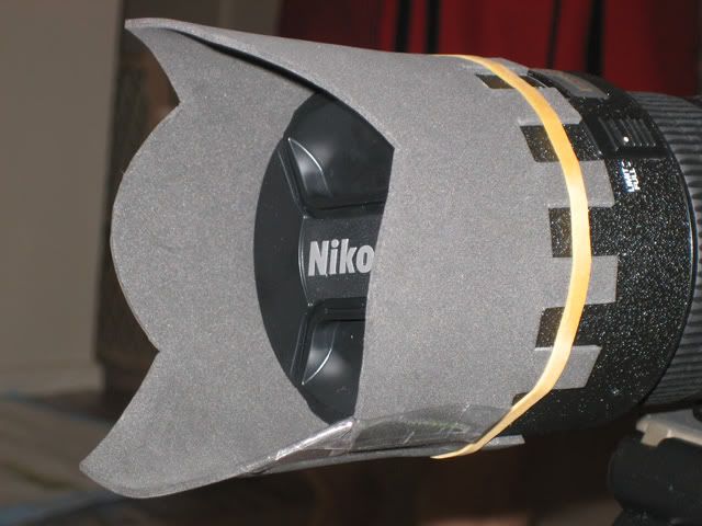

made one using those foam sheets:

AlamakLor,
Quite Good actually. The difference in colour contrast with your lens and body isn't that great. But the visible selo tape can be made neater and probably replaced with a double sided tape.... Can go and bull that you're using some NEW light absorption material |

I went out today with my lens, without the hood...and i was surprised that 70% of my pictures got destroyed by flare, but they were actually salvageable with photoshop.

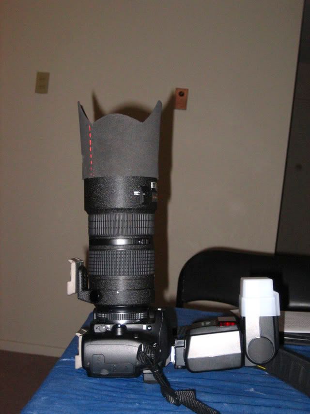

The tape was temporary...I didnt have any velcro with me. I sew them together today and also cut off all those flanges...now it looks like a normal hood and I can slide it onto the lens barrel without problem. I'm gonna make another one tomorrow, with the slightly lonfger neck so that I can slide it in deeper. |

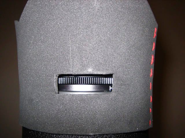

I made another one today, this time I enlarged the size with photoshop to 102%. It is ever slightly larger but the neck is now longer and has better grip on the lens barrel. I've also cut a small holder under the hood for me to access my CPL. ![]() ![]() gonna bring it out for a little test run tomorrow. The color contrast among the hood, body, and lens is not drastic under all lighting condition besides a direct flash. |

please be advised that the material will still reflect some light into your lens from the inside as it is reflective.
Try to hold up a real hood at eye level and look inside, it won't reflect as much light as your material. |

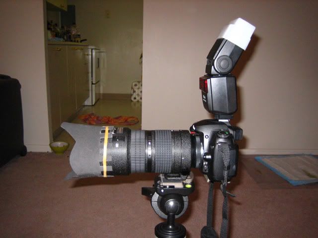

Brought the lens out today again with the hood, works very well and pictures turn out very well as well. However, I noticeed that the flare problem is not from the hood, it's from my freaking CPL! looks like I need something even better than Hoya.
