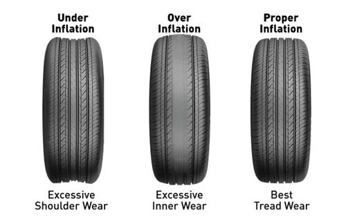

I think 36 psi is too high. In the long term the tyre may wear heavily on the inside instead of the entire tyre surface due to overinflation. Personally, I don't trust mechanics after they finished working on my car. I always watch them like a hawk. Reason, I found out they they almost never check the pressure when they filled it with air. They simply filled it and not bother at what the pressure is. When I had new tyres installed, they were filled to 40 psi!!
Just stick to the manufacturer recommended pressure. Engineers have done it for a reason.

my 2sen on this. just go to a deserted roundabout with tyres at 29psi do a slightly faster than your normal turn (say, normal is 20-25kmh, now do it at 30kmh) and do it again with 36psi. Does it affect your car cornering abilities? If it doesn't then it is pretty obvious the "overinflation" is still within safe limit.
I run my tyres "over"inflated since 15yrs ago. NONE of them displayed what a member illustrated in the infographic above. Norm for me is 240kPa for saloon cars and 280kPa for MPV. Factory pressure is 210kPa for cars and 240kPa for MPV. So I guess the experts definition of overinflation is anything nearer to the max pressure that the tyre is designed to take, for e.g. 350kPa or above.
Of coz one should take into consideration the build of the tyre sidewall. In this aspect, the only tyre I pump closer to stock pressure was XM2, as it has pretty stiff sidewalls.

Heck , I even go up to 41 psi in my Toyota Avanza 1.3 since years ago ........ and had tyres replaced with 2.0 mm tread depth left at 115,000 km usage .
No, it doesn't have uneven wear at centre portion as often said here.
