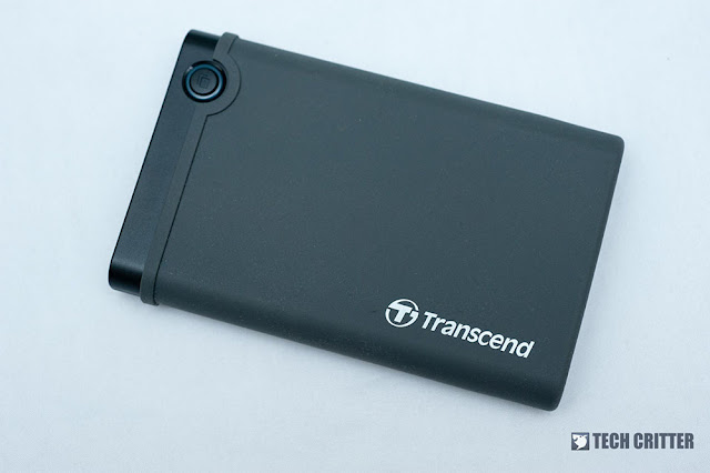

Installing the Transcend SSD230S 256GB SSD into the Transcend StoreJet 25CK3
For this part, it's pretty simple. We've gone through the installation steps in the original review of the Transcend StoreJet 25CK3 here.
In summary, it's simple. Within the packaging of the Transcend StoreJet 25CK3, it has a complete set of accessories that will get you through from the beginning towards the end. There's a screwdriver, a USB 3.0 micro-B to USB-A cable, the enclosure itself, and also a spacer.
That spacer is important as there are 2.5-inch storage drive that are either 7mm or 9.5mm in height. That spacer is meant to fill in the 2mm gap if you have a 7mm storage drive.
The installation steps are rather straightforward too - dismantle the entire Transcend StoreJet 25CK3, take the PCB part and connect it to your storage device. In this case (pun intended), we're using the Transcend SSD230S - a 7mm-thick SSD. Hence, we'll have to use the spacer. Just place it on top, and position everything back into the enclosure and screw it back shut. Then, wrap the protective silicon sleeve back on and you're done!

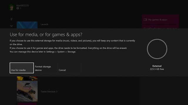

Preparing it to work with XBOX One
Many might think that the SSD will work right after plugging it in - but since when are things so simple, anyway?
To get an external storage device to work with the XBOX One, we first have to plug it in and format the external hard disk to the appropriate type first.
The main option here is to choose your install priority. If you choose the priority to install it to your external storage, then you can literally bring it out and about to play using other XBOX Ones - granted that you sign into your XBOX Live first. The other option is to prioritize installation to your internal storage first - then when it's full, the game files will overflow to your external storage device.
In this case, we're prioritizing installation on the external storage - as we want to show you the impact of doing it.

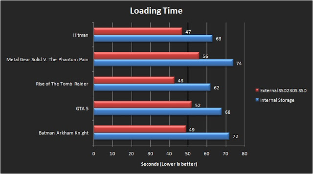

Benchmarks
So the first thing that crosses everyone's mind is this - how does it impact your gaming experience? Sure, I have more storage space now, but doesn't it affect my game loading speed? And the answer is yes - yes it does.
The SSD will be bottlenecked by the USB 3.0 interface. However, the IOPS should be higher than a conventional mechanical hard disk, and an SSD will have better random 4KB read and write speeds too.
In this test, we're only going to try game loading speeds, as that's the main impact when it comes to storage devices on a console anyway.
Verdict
Having games stored on an external SSD does benefit gamers who don't want to stuff everything into the internal storage because XBox One owner should be aware of the internal storage drive which gets very slow overtime and games like GTA 5 and Batman Arkham Knight can really take up to 1 minute to load into the game.
Storing your games (digital copy) into an external SSD can do more than just saving you some extra space on your internal storage. Blazing fast performance is something you can really expect from an SSD and our game loading speed benchmark is the proof - because numbers don't lie. The best part of this is, you can bring the external SSD and plug it into any XBox One, sign-in to your XBox account and you're good to go with your favorite titles without having to re-download everything.
