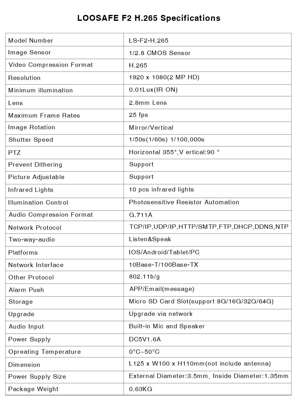

I received this cam on monday and after two days playing here are my findings
Pros
1. Works very well with my Synology Surveillance Station (SSS) eventhough this cam not even in the compatibility list
2. Works very well also with all SSS functionility (motion detection edit, recording, patrol, scheduling, file size, and all advance features of the SSS)
3. Recording full HD H264 into the NAS
4. PTZ works fine with V9 App on my phone,
5. Intercom works fine with V9 App
6. motion detection works
7 .Infra Red Night vision works like charm
8 . WIFI connection also good no lag, tried with ethernet cable also work with SSS.
9. Wifi setup a breeze, Loosafe provides instruction in English, the Cam even has voice guidance when setup like "Camera attempting to connect to Wifi please standby" Setup completed you can use your cam..." something like that, which im quite impressed.
10. Tried using celcom data and line outside the house also works
Cons

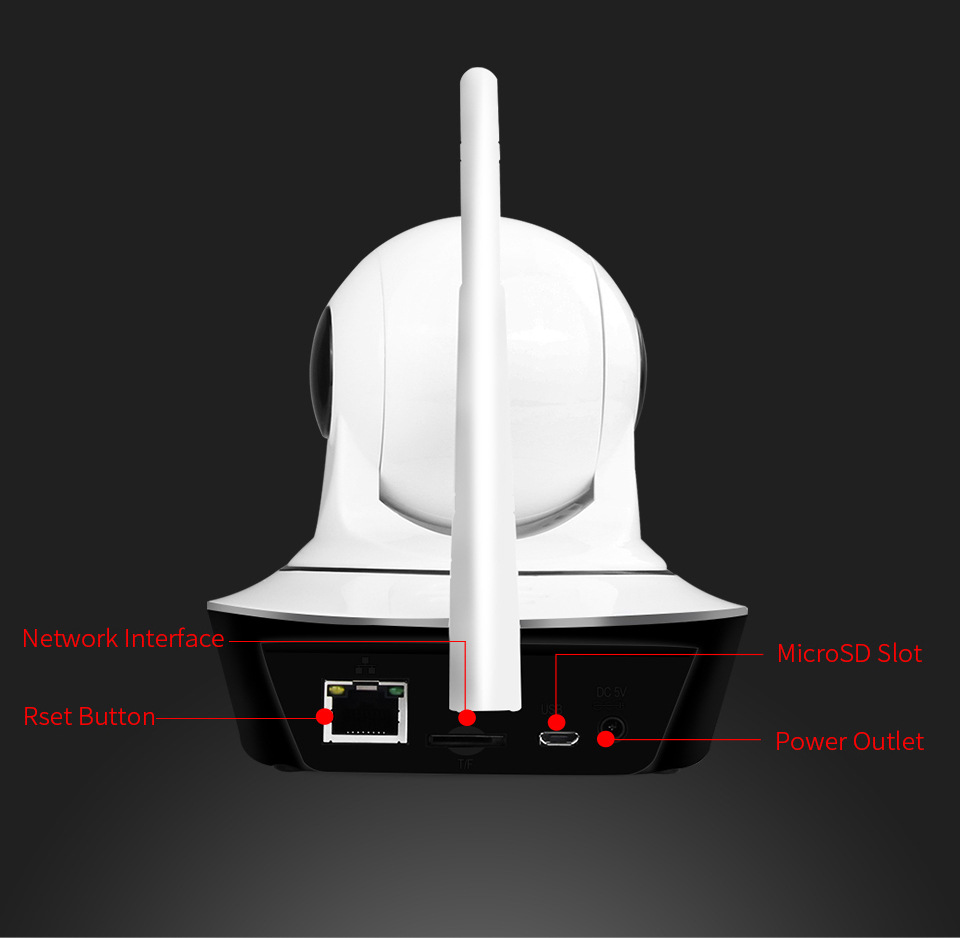

1. POE doesn't work, i need to connect with 5V usb power supply
2. H265 streams cannot be detected by SSS, thus only recording 1080p H264 causing the recording size at 10GB per day. I dont think its the camera problem some synology listed camera also have this problem https://forum.synology.com/enu/viewtopic.php?t=128914
3. DS Cam app by Synology for phone doesnt display video stream but it does push notification if motion detected or any other detection. but you can still use V9 app provided.
All in all weighing the pro and cons this cam can be considered as cost effective Home Surveillance system with high end features comparable with those expensive one.
I'll continue monitor whether it has solution to iron out the cons.

POE solution
Around RM7.99
If you have POE switch just buy this injector cable, connect one to the network port and another one to power supply port, Done.
No usb adapter needed.
