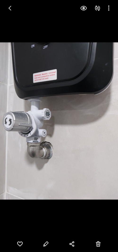

How about this? i'm going to change the angle valve..my current one i think abs chrome angle valve, is it safe to replace it to stainless steel angle valve?

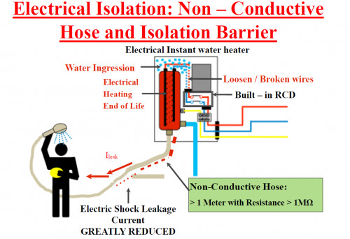

post Oct 9 2020, 11:15 PM
453 posts
This picture will tells you why a conductive hose is not recommended. The electrocution comes from the faulty heating element which are in contact with water. A PVC hose is way much safer.

QUOTE(TerTop @ Oct 9 2020, 11:15 PM)
How about this angle valve? can use stainless steel?
Attached Image Attached Image

QUOTE(smappy @ Oct 10 2020, 01:37 AM)
the plastic pipe go to water heater inlet. is that ok if i change the angle valve to the stainless steel type?
No problem for the water inlet, since you just change the L angle valve - assume you will keep the white flexihose.
It is the water outlet (to shower head) part that must use non-metallic (plastic hose).
This post has been edited by ceo684: Oct 10 2020, 03:18 AM
