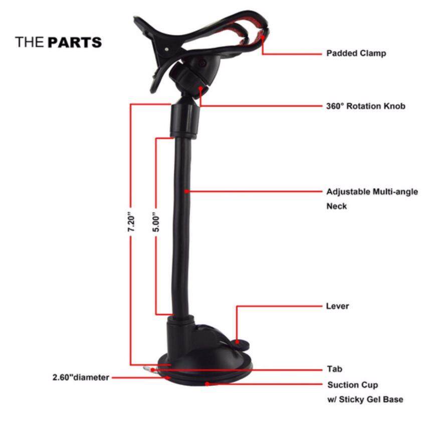

My Phone Mount is keep dropping from my Windscreen after few days usage.
How to prevent from dropping?

Need to put it during hot day. If you put it during cool day, the air inside the suction cup will expand and lose pressure after sitting under the sun for awhile. Also, use water to help get a tight seal.

Water improve the vacuum sealing of the suction cup, closing any small-tiny airgap, which improves the suction cup efficiency. (mostly my bullcrap)
But seriously, water works, no need to wet the mirror, just slightly moist the suction cup. If too wet, the suction cup can move around on mirror.

Suction cup on windscreen is not permanent solution, guarantee to drop after a while.

Once the water dried, the cup will still fall.
Most Phone mount come with a round dish and double sided tape, stick it to the dash board for permanent peace of mind.
Also instead of letting the phone dangling, I added a rubber pad at the dashboard so the phone rest directly on it while being held by the phone mount, fail safe, never drop after 2 years of use.
