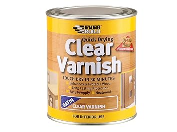

^pomen_GTR^
post Jun 19 2017, 02:31 PM
1,077 posts
Joined: Jan 2013
QUOTE(subaiku @ Jun 15 2017, 08:00 PM)
Hi guys, any carpentry sifus can give suggestions on what to use to protect and seal a wood veneer surface? I want to retain the natural colour as much a possible and not make it darker. I asked a few carpenters but all they use (they say lah) is shellac?
I tested one and even the lightest shellac they use makes it a tone darker.
not shellac...
but use clear varnish type...
something like this
