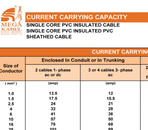

you 2.5mm kabel suspect lah.....
mega kabel 2.5mm kuat until 21 / 24amp...
i use it for DC solar panel (2 x 10amp - max) which is 20amp...as per their table, its good for 24amp dc (2.5mm), and its cool when i touch.....definitely quality counts for something... biggrin.gif biggrin.gif
