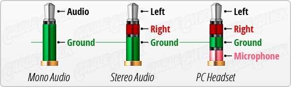

you dont seem to understand jacks and how they work, a jack has 1-4 ring types. (4th ring not included in the picture below)
notice that the mic is the last ring? what you need to do is connect headphone out, which is hte first 2, to the last ring.
if it doesnt touch, it wont work. which is the problem because in the female jack the mono and stereo takes up the deepest part of that love tunnel, while the mic takes up the entry. so technically you can hang a mono cable to the entry la, but its not very reliable
since you have a focusrite and mic and all that stuff, why not just direct mic it up
the other option since you have an iterface is connect the line out of the interface to your iphone via usb, it may work but sometimes iphone no such driver and you get nothing. most of the time iphones are more forgiving than andorids on such drivers so its your best bet.
you can try a 3.5mm to a 3.5mm mono jack to your handphone la, they come cheap and you wish to god that jobs designed the phone female in to be able to get your mono male. chances are it wont work but hey its like a 20 bucks bet?
