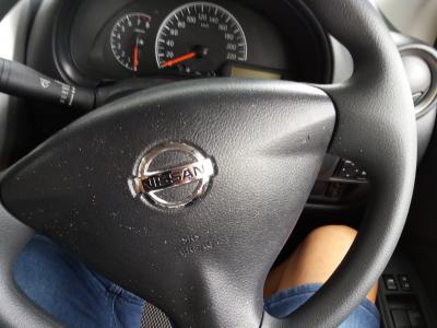

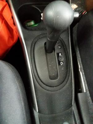

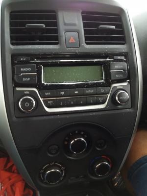

Something horrible & terrible happened to my new Nissan Almera (which I bought in 2016 but still at very low mileage as I only drive quite a short distant during weekdays).
On 23 December 2016 (Friday), something horrible happened, after leaving my Almera at home for 6 days (without driving), and as usual, I started my car engine & switched on the air conditioner & all of the sudden the air-cond blew out a large amount of “snow-like sticky white films” (which I never seen before !), the amount of this “white films” was so huge that it stuck all over my body, my face, nose, mouth & the entire car interior... As a result of that I was coughing non-stop but I immediately drove my car to the nearest Nissan service centre in Chan Sow Lin KL for inspection... & the supervisor there told me that he has seen a few cases like this before, where car owners left their cars idle (without driving) for 3-4 days & then when they started the engine the air-cond blew out sticky white film (similar to my case). I was terrified because the entire car interior & my whole body were covered with this “snow-like sticky white films” but the supervisor told me it was just “normal dust” - which I don’t believe because as a car driver for more than 20 years I had never seen anything like this (sticky white film), or heard anything like this before. For sure it was definitely not the kind of "normal dust" we see every day !
Since the air conditioner works on close-loop environment & in order to get rid of the entire mess, I have vacuumed the car interior a few times... also, my family have to wear face mask (when using the car) because all of them have serious sinus problem (and regularly taking sinus medication), but still, after a while of driving, this “white films” will appear again.. although with smaller size & lesser quantity now, still, it can be seen all over the car interior… and since I have coughing almost every day now, I have to stop driving the car for the time being because I just can’t keep vacuuming the car everyday…
I have taken a few photos (of those white films) & in fact, my Almera has just undergone the 2nd scheduled service (i.e. 10,000km) about a week earlier...
Can anyone kindly enlighten:
1. How could that happen ?
2. What are those snow-like sticky white films (that emitting out of the air conditioner) ?
3. Are they dangerous compound & hazardous to human ?

Attached are photos that I taken on 23 December 2016..
This post has been edited by MIRAMAX: Jan 22 2017, 08:20 AM
TSMIRAMAX
post Jan 22 2017, 08:17 AM
11 posts
Joined: Apr 2013
Attached are the photos (of those white sticky films)
Attached Image Attached Image Attached Image undefined
This post has been edited by MIRAMAX: Jan 22 2017, 10:38 AM
