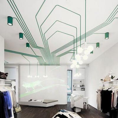

conan86
post Jan 22 2017, 12:45 AM
396 posts
Joined: Sep 2007
From: T@M4n DeSa
do this style haha
expose style
or
for me im looking into this 2 options as i see hacking , cement n plaster cost soo exp n lets say if wire rosak n u wan it to b replaced gonna b a hassle .. so just let it expose biggrin.gif
This post has been edited by conan86: Jan 22 2017, 12:46 AM
TSWahBiang
post Jan 22 2017, 07:52 AM
3,718 posts
Joined: Nov 2015
QUOTE(conan86 @ Jan 22 2017, 12:45 AM)
do this style haha
expose style
or
Looks nice but guess not cheap either...
weikee
post Jan 22 2017, 11:03 AM
10k Club
12,019 posts
Exposed Gi are more expensive than hacking. Is the detail skill that are costly.
