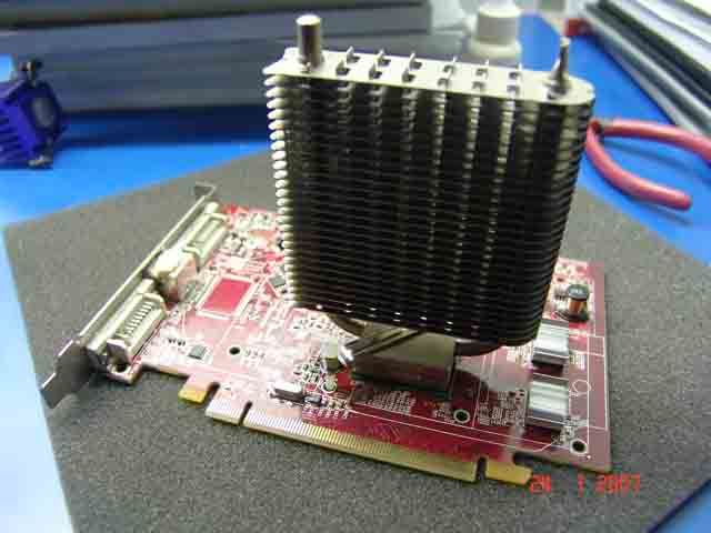

Ok I promised you guys a TR mod so here it is. It will be a semi-guide/pictorial.
I will be using a HIS X1650 Pro graphics card, but I think you can use this mod on most cards that use the same mounting system, but I strongly suggest that you don't use this mod on any card higher than a 1650xt, because I doubt that it can handle the heat loads of the high end cards. Also once you use the hr-05, u can't fit the card
into a case anymore as the HR-05 is very tall.

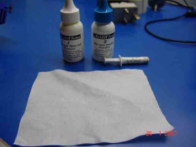

You will need:-
1) Needle nose pliers
2) A small Philips screwdriver
3) TIM, mine personal choice Arctic Silver 5 or Ceramique
4) Arctic Cleaner 2 Step cleaning solution
5) Tack Cloth or any cloth

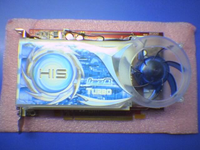

Ok let's start of by looking at the card.

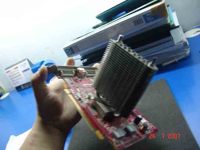

It uses an old school Arctic Silencer. Even though it is quite and U.V. reactive, I think my hr-05 can beat it.

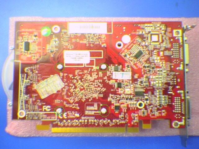

You can remove the heat sink by unscrewing four screws at the back.
Look at that, the amount of aluminum of the stock heat sink is a lot.

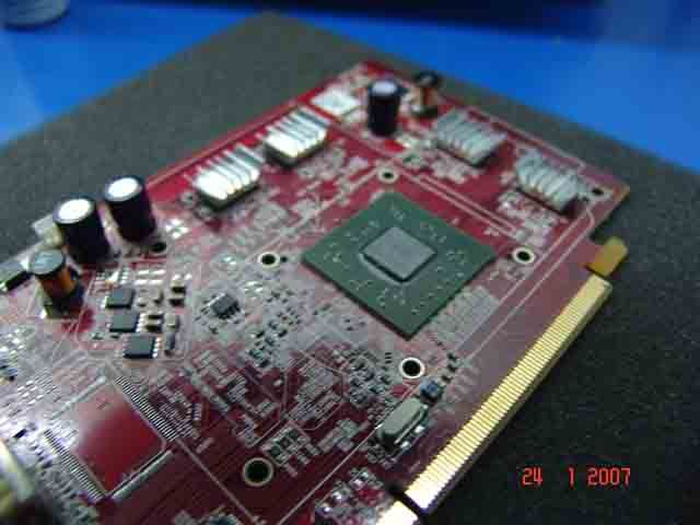

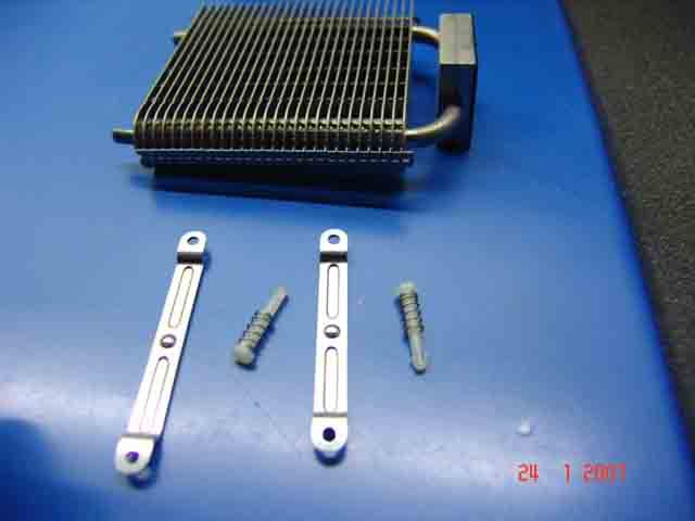

Here is your HR-05 kit.

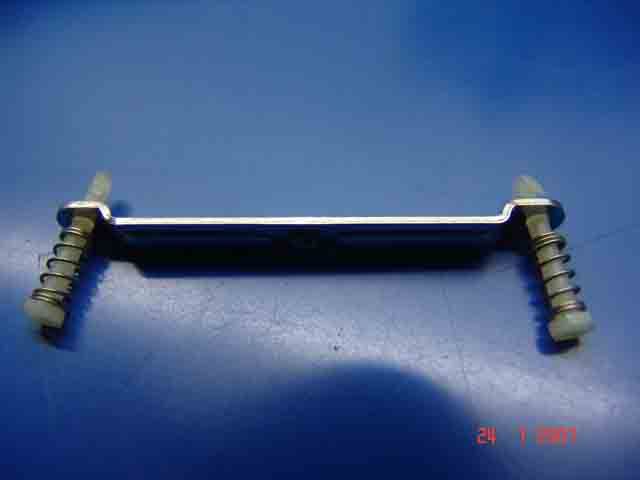

Take the longer cross bar, and put the push pins through, like this.
Apply your Tim, but before that remember to clean the core and the base with arctic clean.

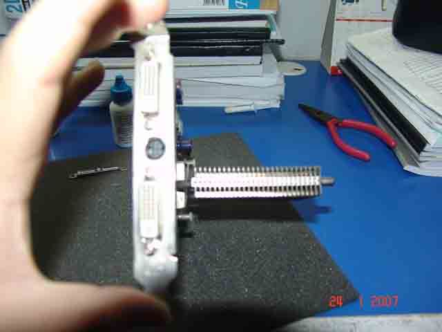

Then just push the pins through the cards mounting holes, I suggest you orient the heat sink in the way I have, if not the heat sink will touch the PCI slots.

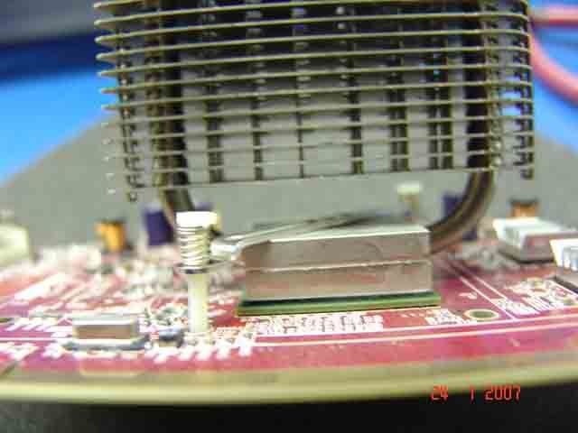

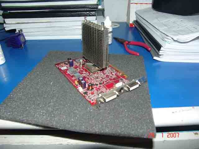

And you are done. Simple right, took me less than 10 minutes.
Here are some more shots of it.

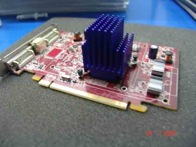

You can also use many other chipset heat sinks, like this the ZALMAN ZM-NB47J.

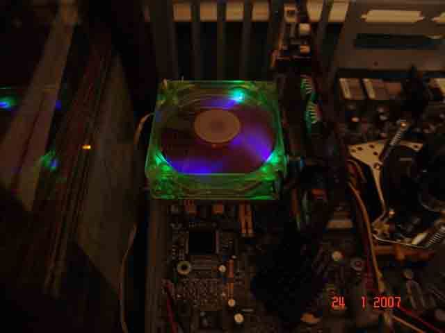

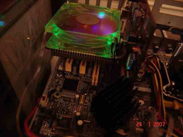

Some shots of it running with a fan mounted on it.
