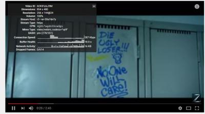

Sigh....exactly 1:00AM....youtube turbo full 400kb/s......
That damned IPV6 youtube CDN......
50kb/s youtube buffering non-stop..........1:00AM ---> 400kb/s
EDIT: The problematic CDN
kul01s05 : router: "pr02.kul01" next_hop_address: "127.0.0.1" (2001:e68:4000::/36)

QUOTE(dannielshazmeer @ Oct 15 2016, 10:05 AM)
IPv4 and IPv6 performance are pretty much equal
Except IPv6 performance on Malaysia youtube streaming.
What can I say....right after 11AM.....50kb/s
For the 10 5 or 8 seconds before clock strikes 11:00AM...I got 400KB/S.....then 50KB/s......
EDIT2:
That it vmad.gif ....everyone with 50KB/s IPV6 youtube throttling should send feedback together with CDN info.
First, visit https://redirector.googlevideo.com/report_mapping to find out your assigned CDN.
Then visit youtube website, scroll down to bottom and click 'Send Feedback'
Make a feedback on Malaysia youtube CDN server with explicit mention of IPv6 slowdown to 50KB/s during 11AM to 1AM.
EDIT3: Make sure write that you are TM Streamyx subscribers.
The more people complain about this to youtube.......the better.
Do realize this 'throttling' session has been happening since 2013.
