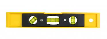

which results in ponding. simple but bad problem. your contractor need to use the spirit level conscientiously to ensure the gradient is right...
