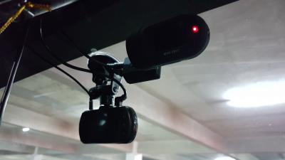

Mount with built-in GPS
Attached Image Attached Image
0807 with mount attached

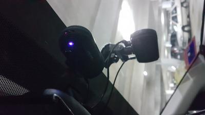

Can you also share the pix when it is mounted on the car?
Can't tell how small is this.

QUOTE(sebastianX11 @ Jun 13 2016, 04:51 PM)
Not sure if you can see from this picture... I can't take a picture from the rear as it's hidden behind my rear view mirror...
