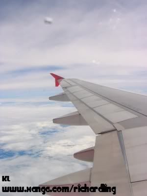

there is a blur dot on the left top corner.
how to get rid of it?

no one wans to reply me.
it is the problem with the lenses? it gets clearer when i zoom in. |

other pics got?
and exactly at the same spot? then it's dust on your CCD. but it doesnt look like a dust though |

other pictures still got.
and yes, it is at the same spot. >.< (help me) |

i wiped the len with a piece of cotton cloth.
and it is still there. |

izit still under warranty?
try to go back to the shops to get some help loo..(old ways to get thing's done) ask uncle google( faster and easier way) |

There are two possible spots where the dust is;
1) on the back of the lens (where it meets the SLR) 2) on the SLR sensor itself (requires you to clean the sensor with a blower. DO NOT blow with your mouth as 'wet' dust is stubborn.) If your camera is still under warranty you'd have a good chance of getting it cleaned for free. After getting it back, remember to be quick when changing lenses. Try to change lenses in a clean, dust-free location (avoid the beach, for example!) ...if it's not a digital SLR, then I have no idea how it got in there, and you'd really have to send it for warranty. LOL. |

that dot looked like a water spot...
what camera are u using? |

it looks like oil.............
